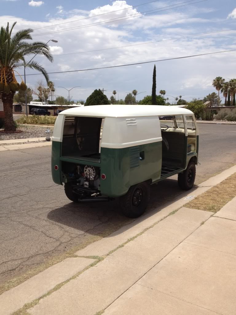

PostPosted: Sat Jun 02, 2012 5:30 pm    Post subject: Reply with quote
It has been some time since my last post. I was working on a friends SC for the last few months. Finally got that out of the way.
Today, I put in the bay window gas tank. Messaged the middle to fit the tranny hump, then made som extender straps. After I finished that I installed my engine. Had some interference with the throttle bar and the tank seam, so bent those down some and now I'm golden. Wouldn't of had this problem with standard tin, but because of the Bergman unit the carbs have to mount with throttle bar to the rear.
Tomarrow I will get the exhaust going.

PostPosted: Sun Jun 24, 2012 1:58 pm    Post subject: Reply with quote
Engine is running. Took the bus up and down the street today. Other than a reverse lockout problem, everything is working great. Need to get busy with bodyworking the doors.
