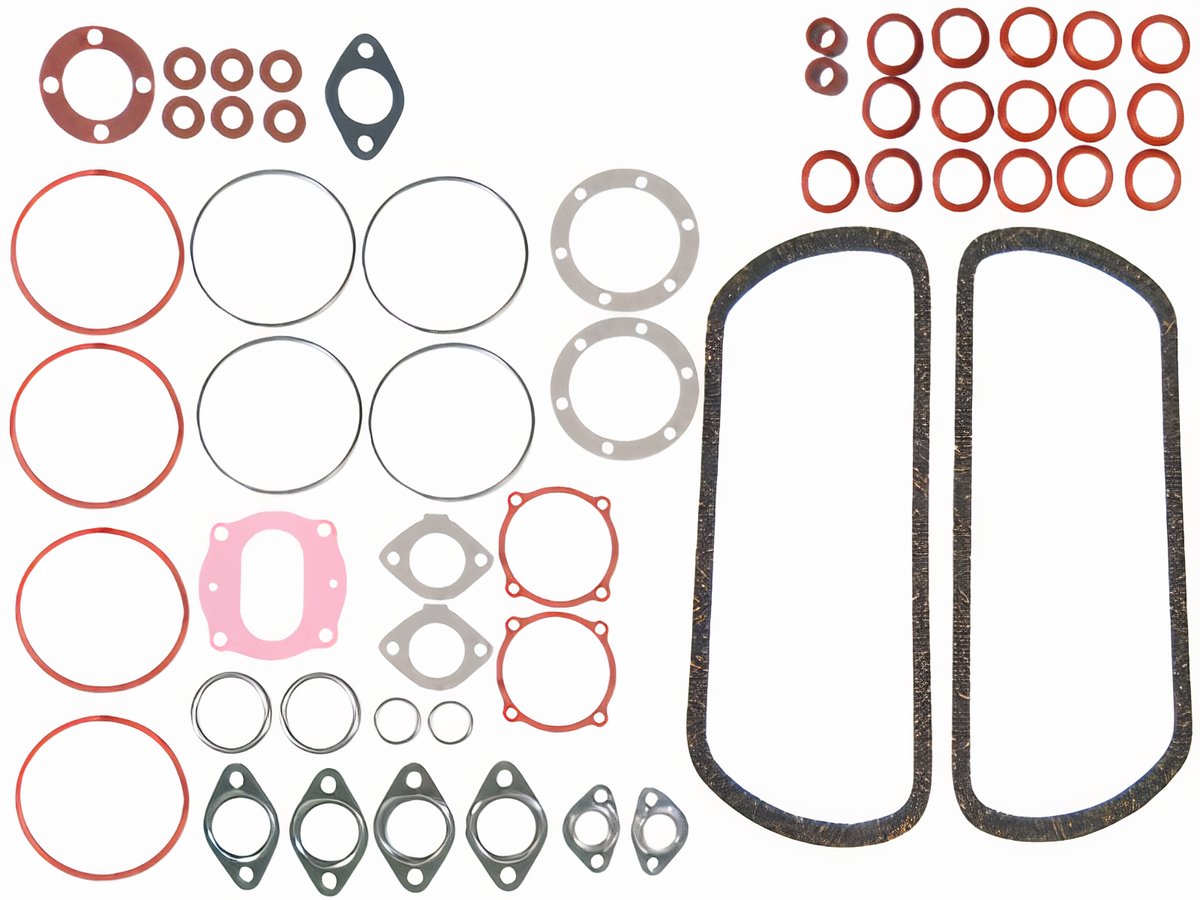

The 40HP was a complete redesign of the flat four aircooled engine. Very few 36parts cross over. Some of the gaskets do, like the oil pump and pushrod tube seals. Depends on what variety of 40HP cylinder heads you have as to which intake seals you have. If it's fresh-air and has the later heads with 34mm diameter intake ports, you can buy an Elring 1300-1600 gasket set and get all of the gaskets you'll need for a rebuild.
You mean the donut seals between the heat exchangers and the muffler? It depends on what you got, stale air are 32mm diameter. (that part is the same as 36HP) Fresh air are 35mm, same as the tailpipes and same as later models.
