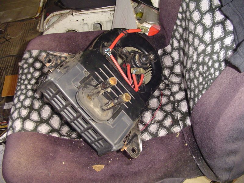

I spent a decent part of the day trying to liberate the heater from the Mitsubishi to use in the VW. When I got the fan out I realised it wasn't going to happen. it's huge! So I focused my efforts elsewhere.

Trying to figure out if i have the basis of some sort of front heater / demister in what I have. You can see the fully functioning recirculating under seat heater form a Toyota Land Cruiser under the back seat. It is using the current fan relay to drive it. Two wire install. How easy. But i do need a windscreen demister for it to be legal. A tough nut to crack for sure.

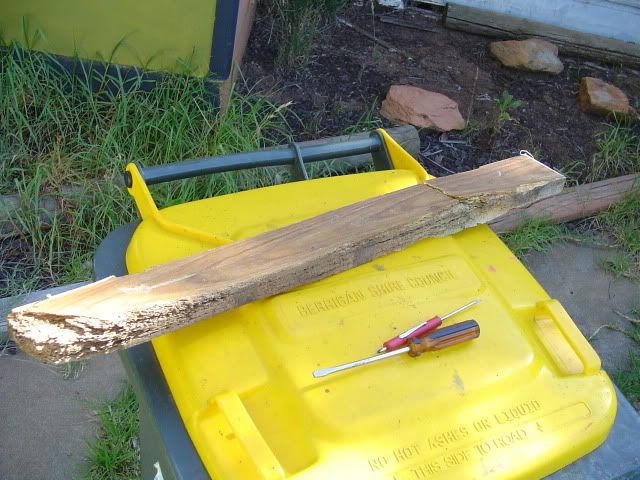

That's the rotten bit I cut out. By sheer luck the water damage stopped where the cabinets intersect the back seat. Also incredibly lucky was that the cabinets were the right width considering the back seat in the bus they came from was of a different design.

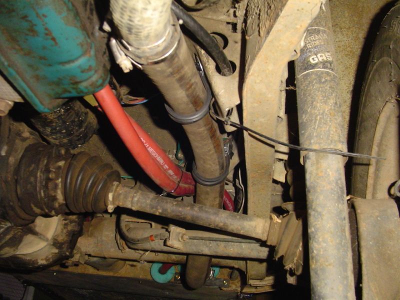

No photos right now, but I just did a semi test-fit of the P clips. I used a couple of big panel washers and a bolt to secure them in frame holes like the arch one above the diff, and the diagonal ones above the trailing arms. Did one of each while looking for optimal positioning and realised I need a total of four. Went and bought another two but honestly I'm tired, and want to procrastinate on one of them because the exhaust and the brake vacuum hose make it a massive nuisance.

Here we see the P clips that I had an utter bastard of a time getting. When I was halfway through installing them I found VulcoFlex hoses at a garage sale to my needs. I did what anyone would do and said "F*** it. It stays unless I have a damn good reason to change it.

The rotten remains of the table should go too. I've found two options. try to cut down the remains of an old laminated world map student desk top to size, which could be problematic because of the laminate, or cut down an old wood board door that used to be on one of the outbuildings, strip the paint, sand it and laquer it or something. The total depth may not work with the special table hinges.

Once again I'm stuck. The heater I bought may be next to useless because it seems to be a 24 volt unit. Add that to the pile of other bits and pieces that are piling up and it's not a happy experience.
I can't progress with the interior because I need sheets like ply and have no way of transporting them. I need to get those brake hoses but can't right now.
I'd like to keep going but I'm at a bit of a loss at what I can do right now.
If the heater can turn with 12v I may have to do something I was actively trying to avoid and mount it in the stone guard area if it fits. What concerns me is environmental hazards for it like submersion, and for us like low hanging pollutants. I don't know. maybe it'll do like that for now, but I don't know how to remove the front bit of heater tube non destructively anyway.
Alternately if the coolant pipes on the heater core could be shifted that would open up a few more options. I suppose if the pipes are a common size (unlikely) some copper pipe fittings, solder, flux and a hacksaw could take care of that. Just thinking aloud here.

Here's a couple of shots of the cruiser heater. Pretty much the same as the one providing heat in the back already except its 24v, it has a relay or something, the plastic front is a little different and the coolant valve and pipes have been moved a little.
