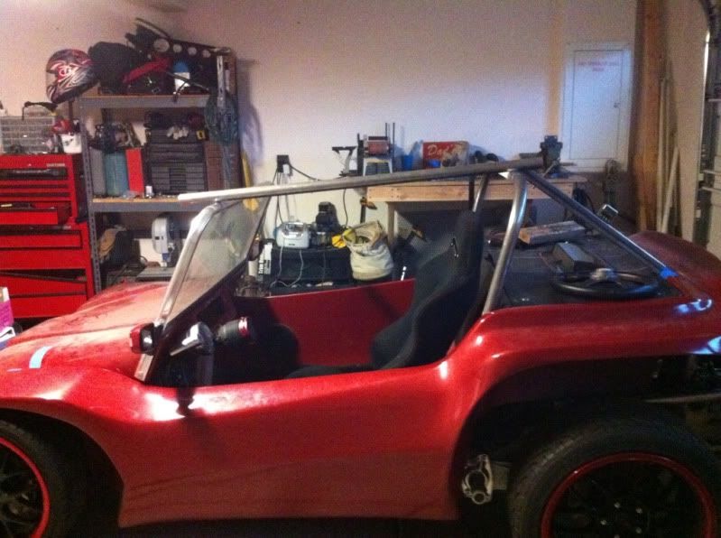

Starting to plan my cage

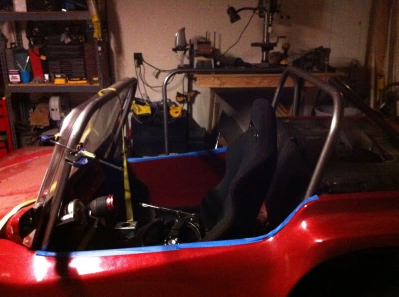

PostPosted: Wed Apr 11, 2012 12:14 pm    Post subject: Reply with quote
Entry up the main hoops. Will try and get them connected this weekend

Wow. This was a build that I closely followed.
The cage is coming together nicely, and thanks for your business.

What size tubing are you using for the cage? I'll want to talk to you about hooking up the stinger to the Subie; I'll be running one in my Coyote.

Cage is 1.5". The exhaust tubing is 2.5". Subi is that way to go.

1.5? It looks really fat...I like it! Cool
