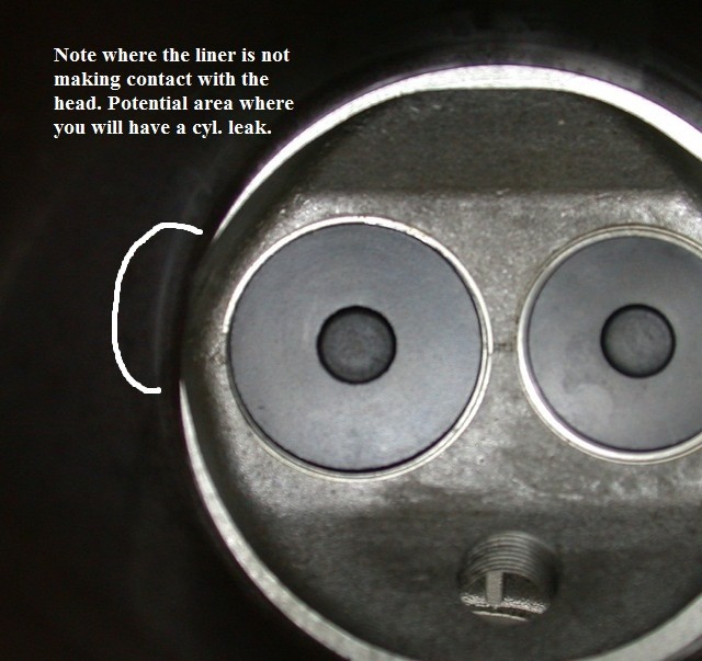

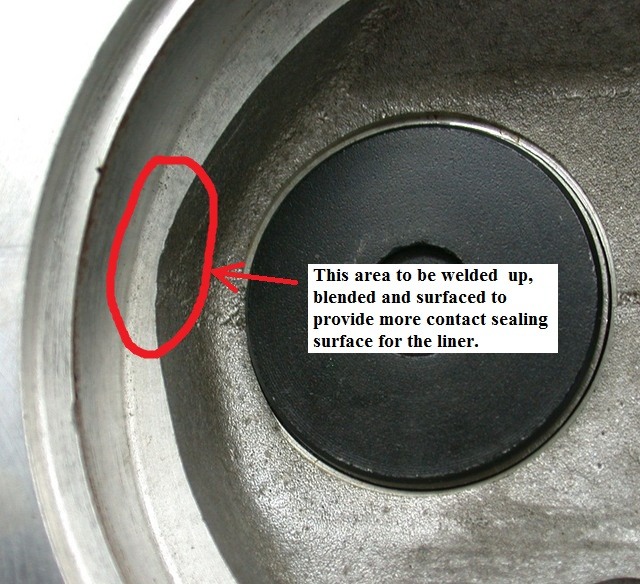

The purpose of these photos is to show where there needs to be additional welding/machinework done to
the W.West dualport 36hp head before it is installed out of the box. The aluminum shrank when it cooled
when the head was cast, thus reducing this important sealing area for the liner.

are all the WW heads like this? If a pair were not welded & surfaced, and merely bolted on out of the box, would there soon be engine trouble?
There have been issues with the WW heads in the past but from a previous topic on the subject WW seem to be pleased to replace any head seen to be defective: http://www.thesamba.com/vw/forum/viewtopic.php?t=402541
I'm not sure what purpose it will serve to get into another p***ing match on the subject especially here, a topic to illustrate Steve G engine build for his '54 ragtop.
For that reason I've taken the unusual step of setting up a feedback thread on these repro Wolfsburg West twin port heads. If you have personal experience of these repro heads, please contribute to this new topic: http://www.thesamba.com/vw/forum/viewtopic.php?p=5953218 . They, I believe, have sold very well so there should be enough information and feedback from actual users to come to a reliable conclusion.
