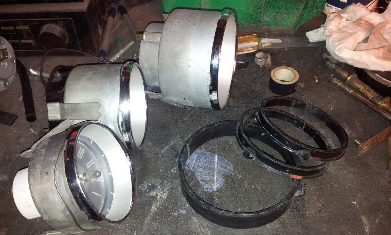

Mark Shutt

OK, this is what I have, what appears to be a later dash top (doesn't have the mounting tabs at front), early clocks and the plastic rings! looks like I'm missing the spring from the speedo too..
the dash pad looks like it has some plastic rings bonded in from the factory..
Brent
Joined: April 28, 2010
Posts: 986
Location: Yokosuka, Japan
Brent is offline
PostPosted: Tue May 08, 2012 9:05 am    Post subject: Reply with quote
Looks like you have an extra set. They are in the dash properly.
You're missing the wave spring on the speedo though.

Mike Fisher
Joined: January 30, 2006
Posts: 12421
Location: Eugene, OR
Mike Fisher is offline
PostPosted: Tue May 08, 2012 9:12 am    Post subject: Reply with quote
Try the speedometer without a spring. The late dashes don't have/need mounting tabs in front.

Mark Shutt

thanks guys, so I can forget those plastic rings I have! if you look at the lower mounting tab on the speedo you can just about make out where I put a marker pen line from behind when it was in the dash, works out about 5mm difference.
