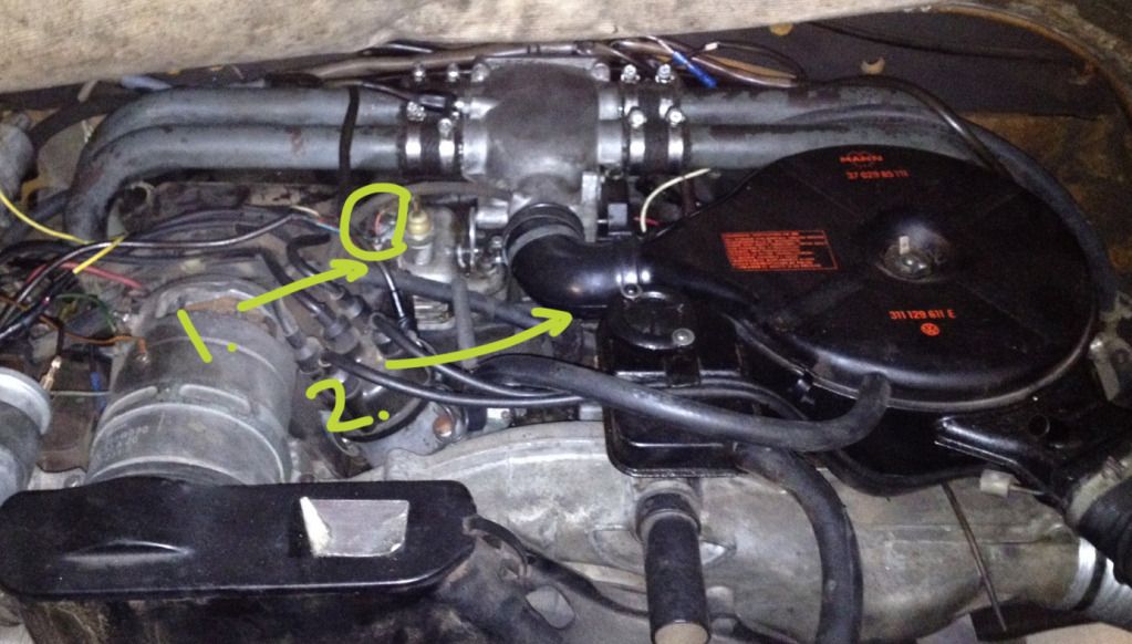

PostPosted: Wed May 09, 2012 4:18 am    Post subject: Reply with quote
Hi, I have a Australian '70 fastback. I've owned it for about 2 years and the whole time it has had problems with cold starts.
For a while I was convinced it was the AAR as it was broken and wouldn't lock into place - but then I bought another and no difference. As a test I disconnected it when cold and the engine started racing - so I know it is doing it's job.
The problem is this;
On stone cold the first cranks there is nothing, then I'll get a odd catch.. then catch and a splutter .. then splutter splutter .. then finally she will run - once it catches it runs absolutely fine with no hesitations and very smooth.
I'm guessing the reason it goes through the above process is when there is enough heat from the attempted starts it will run fine.
I've had the engine out and when installing could only see 2 possible anomalies - shown in the pic below
1) The red wire was unplugged and going to nothing - green is plugged in.. what are these for and are they important.
2) under the air cleaner is a bunch of white wires earthed in a multi plug.. one wire had stripped itself from the plug.

PostPosted: Wed May 09, 2012 9:43 am    Post subject: Reply with quote
Green wire: to oil pressure light sender
Red wire: only used on late automatics-- clipped from the factory fot stickshift cars
White wires on "porcupine": These are injector and system grounds, and a broken wire will cause all or some injectors to fail to squirt. Make SURE these are all clean and tight.
Salty
Joined: April 28, 2010
Posts: 132
Salty is offline
PostPosted: Thu May 10, 2012 4:01 am    Post subject: Reply with quote
Great thanks for that - I'll get that white wire remedied. Any ideas for cold start issue? It's in all temps that it happens.
