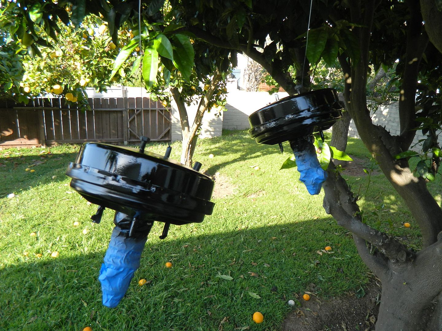

Booster
Booster with parts assembled

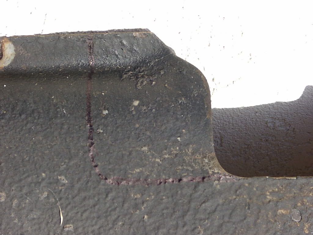

The plate

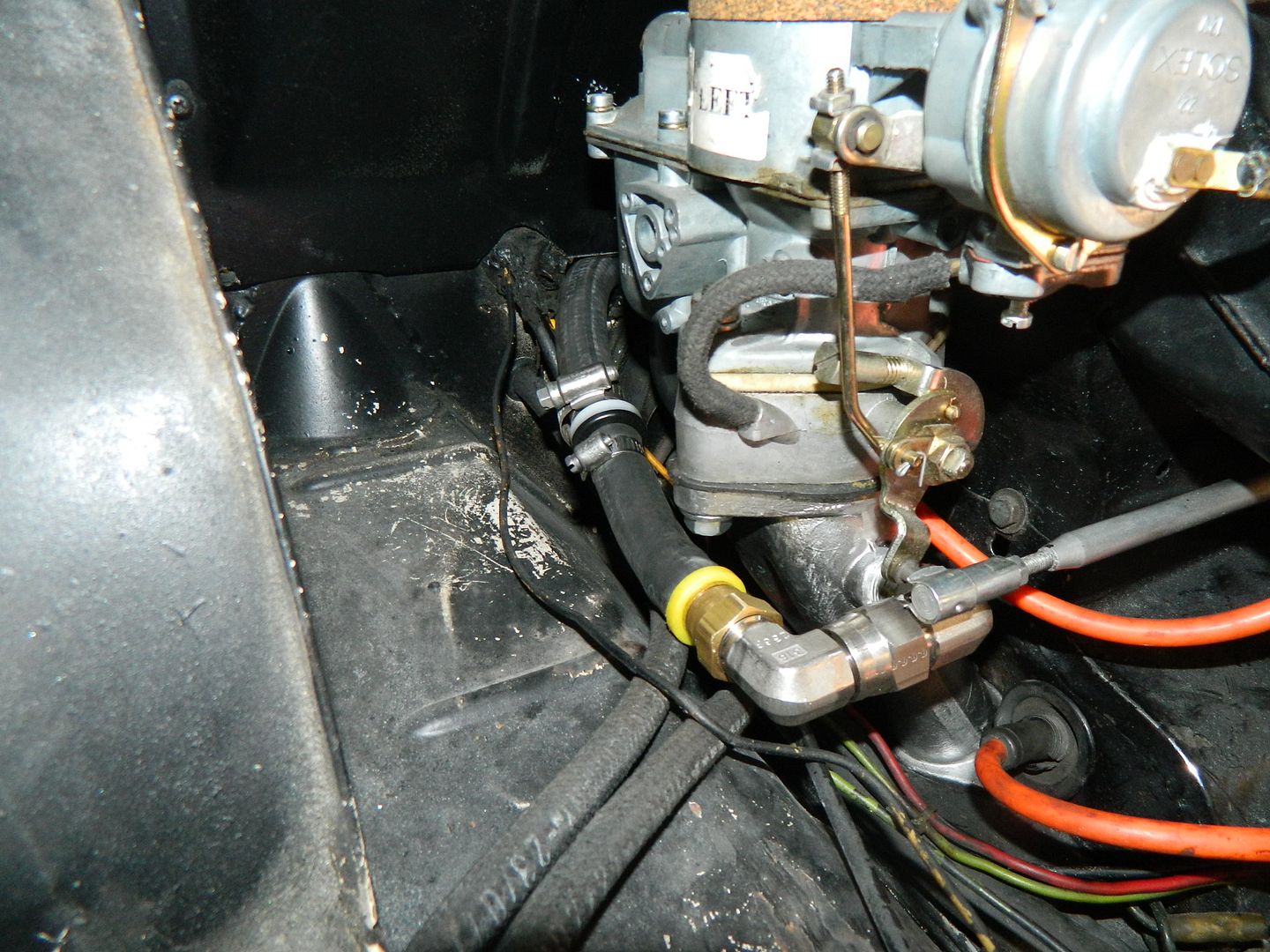

Vacuum fitting to intake manifold
Check valve installed

1) Weld the plate to the beam.
2) Make sure your booster is good. I sent these out for overhaul at $150 each.

11) Whatever set up you have in the way of carbs install the fitting and hook up the vacuum line and check valve.
