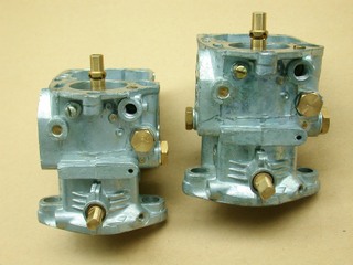

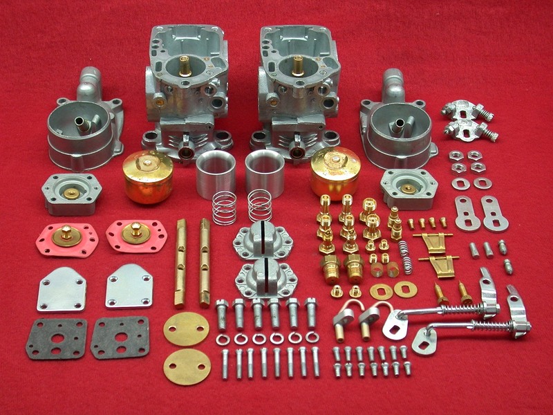

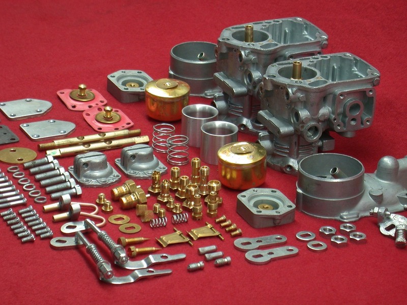

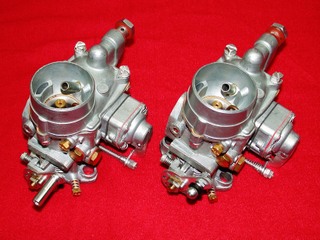

PostPosted: Thu Dec 06, 2012 1:48 am    Post subject: Reply with quote

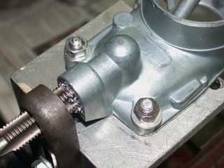

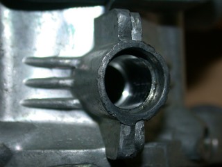

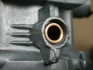

Took apart the carbs now. Rebushed, re-jetted and correct venturi's. Enjoy! Mr. Okrasa Cool

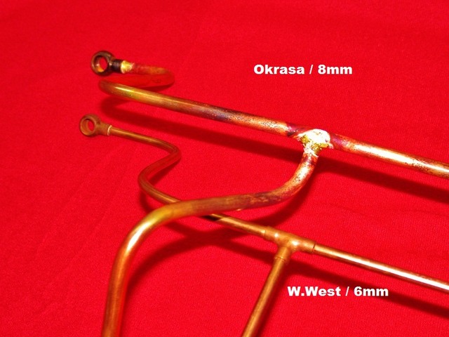

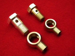

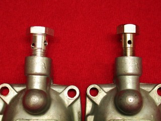

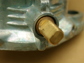

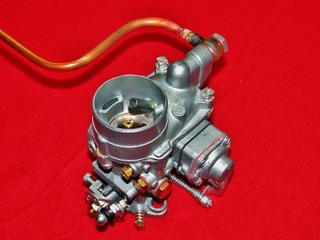

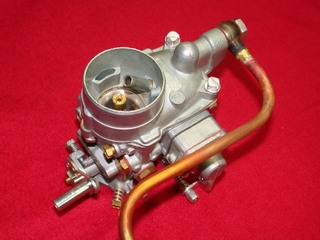

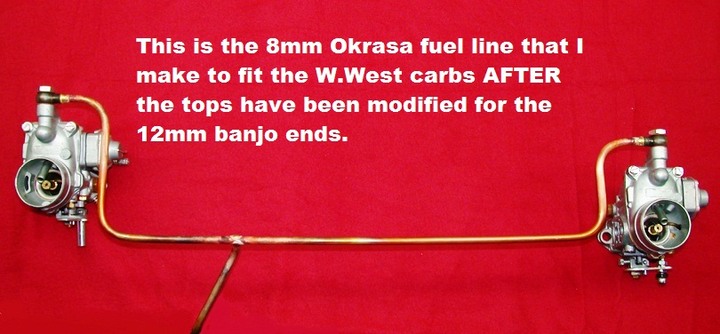

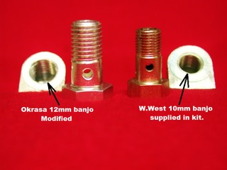

PostPosted: Tue Dec 18, 2012 12:12 pm    Post subject: Fuel Line: Repop vs. Okrasa Reply with quote
Rwoodshvac wrote:
Wow I love the pics of. The carbs
Steve wanted to change directions with the supplied W.West 6mm fuel line to the original 8mm Okrasa type as used on my engines. The fuel line supplied in the W.West kit uses 10mm banjo/6mm fuel line. As per original Okrasa, the line should be 12mm banjo/8mm fuel line. The carbs in the W.West kit dont allow to use the larger/original Okrasa fuel line UNLESS they are machined at the fuel inlet connection. I made up some tooling so I can "modify" the carb tops to original 12mm fuel inlet specifications. Now you can run the original looking Okrasa 8mm fuel line and give your engine an "original Okrasa" look rather than an aftermarked/reproduction look. Enjoy photos! Mr. Okrasa Cool

PostPosted: Wed Dec 19, 2012 10:20 pm    Post subject: Re: Fuel Line: Repop vs. Okrasa Reply with quote
Mr. Okrasa wrote:
Image may have been reduced in size. Click image to view fullscreen. Image may have been reduced in size. Click image to view fullscreen.
Joe, I am speechless with the build! It put a huge smile on my face at a time that I really needed it most. Very Happy

PostPosted: Thu Dec 20, 2012 2:08 am    Post subject: Re: Fuel Line: Repop vs. Okrasa Reply with quote
Mr. Okrasa wrote:
Are the 12 MM banjos the size used on the glass filters? If so where does one get them I have been holding back picking up a glass filter as I heard it was VERY hard to find the fittings.
