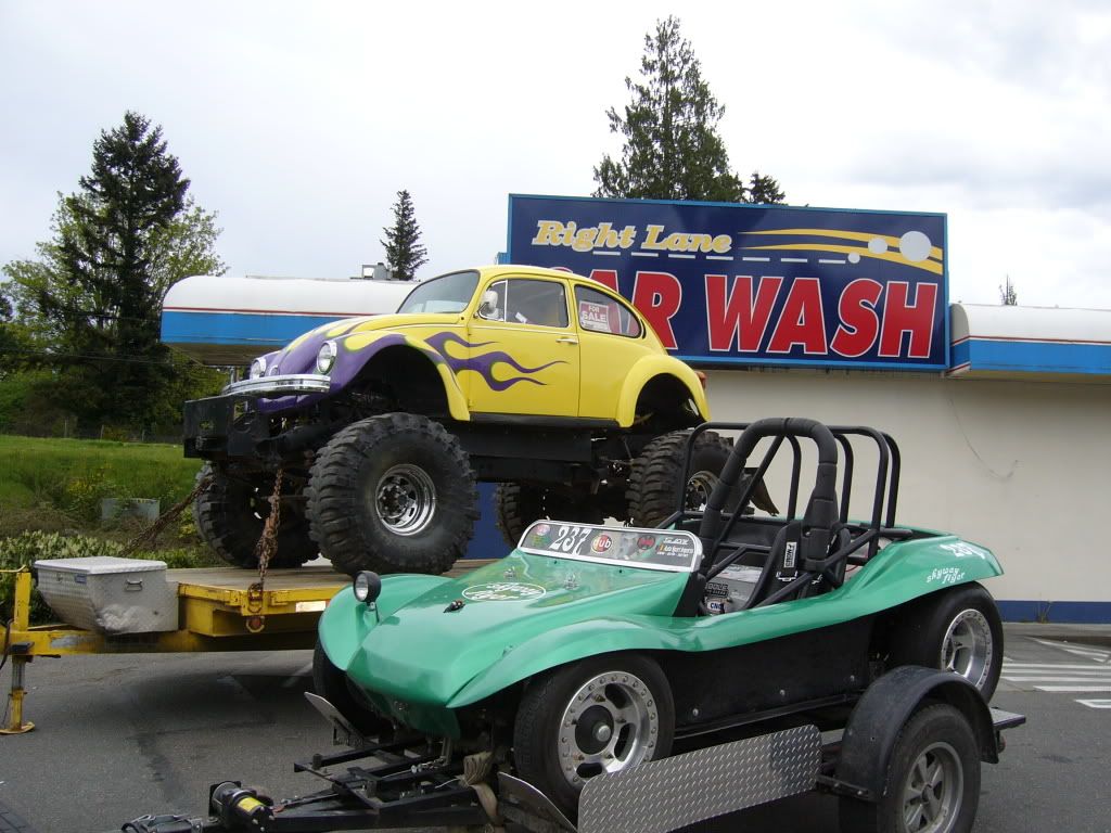

I like a trailer,, here's mine a single axle 3500lb with a 2k winch.Sorta custom built,,, I'm the green buggy. Wink
