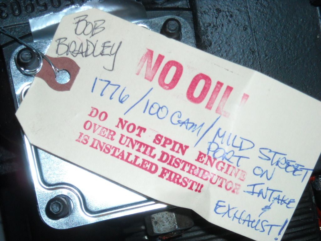

DaBlackSamba wrote:
well i got the motor back this last weekend, nice shiney rebuilt 1776 straight from strictly forign
I don't understand why they've got sealer all over that engine. That's a problem looking for a place to happen.

W1K1 wrote:
kinda makes you wonder how much is inside don't it.
is that stuff hard?
I think it's just regular orange silicone. It hardens but stays flexible, like a rubber band. And yes, it can get squeezed out on the inside just as well. They really gooped it on! Shocked
Sorry, DasBlack- hopefully it won't be a problem but I'm frankly shocked to see that from an experienced engine builder. A very light coating of Kuril is all it should have anywhere.

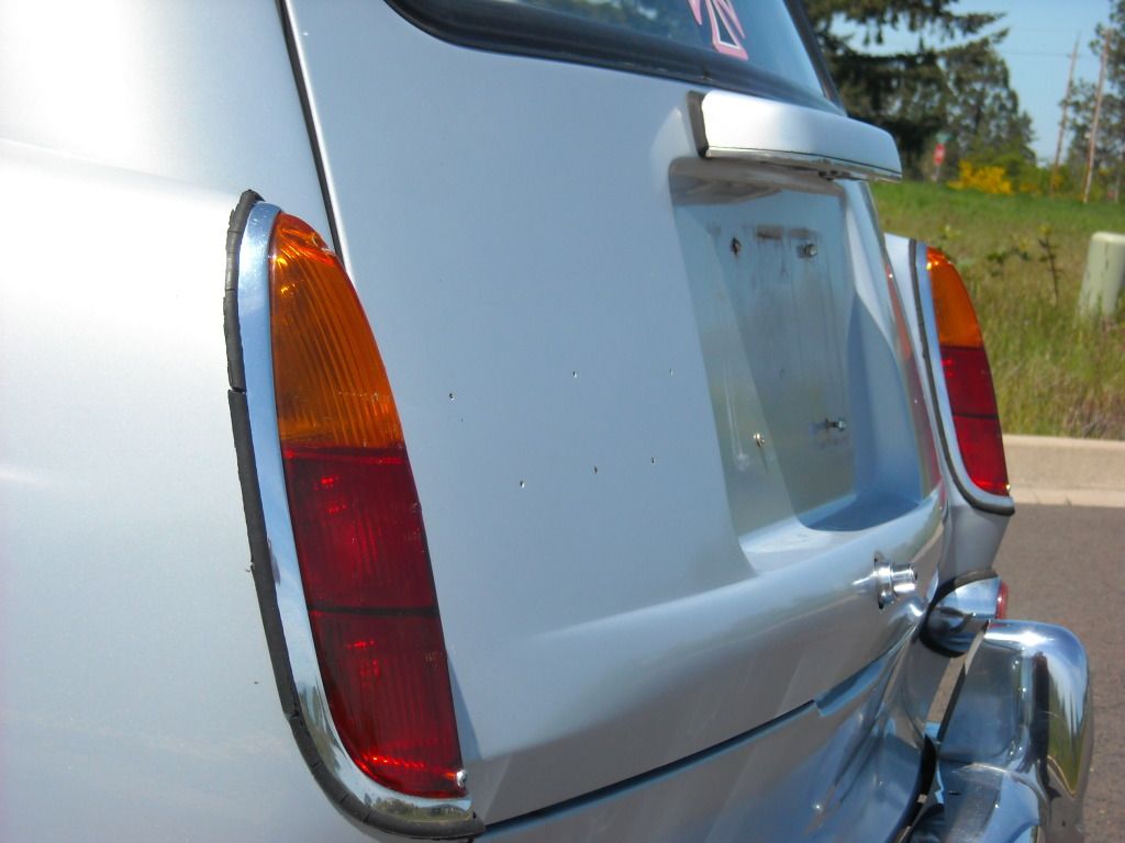

just put on my new flat tops, i like the way it changes the rear of the carImage may have been reduced in size. Click image to view fullscreen.

PostPosted: Mon May 14, 2012 8:36 pm    Post subject: Reply with quote
very nice mate. good to see her on the road Wink
where ya front bumper Laughing

PostPosted: Mon May 14, 2012 10:29 pm    Post subject: Reply with quote
the front bumper isn't pretty, and i put it back on just after i took the pics
new direction for the color since of the shitty ghost flame job, the new color direction is on the C6 corvettes called jetstream blue metallic

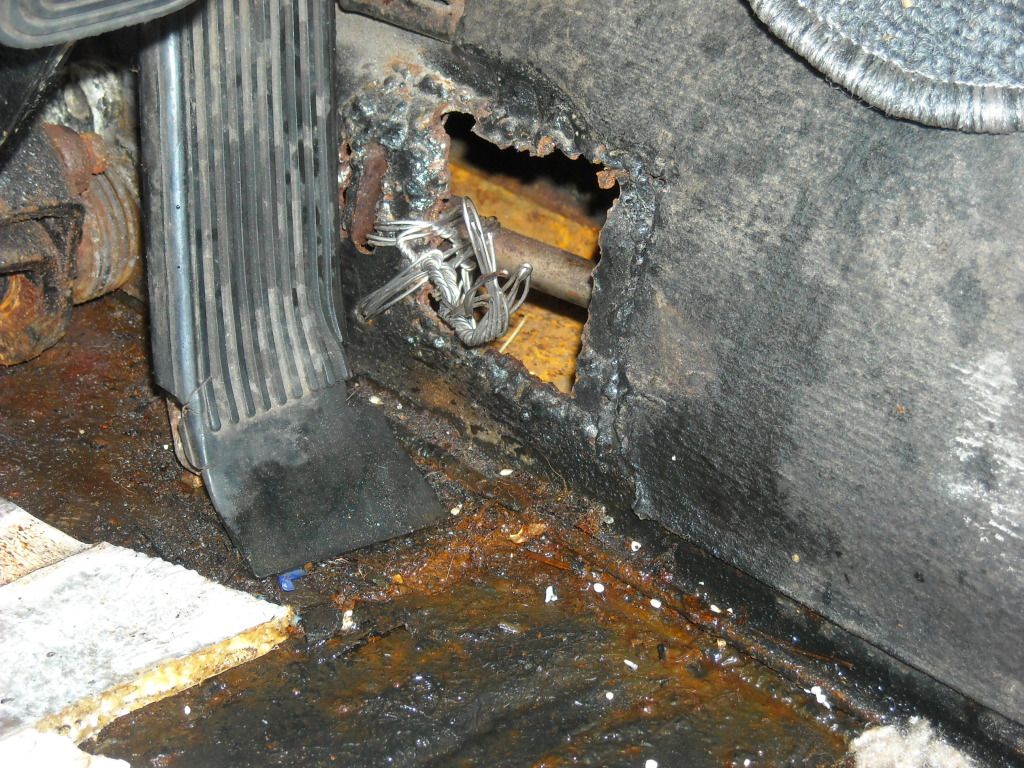

well i am pulling the plug on this project, going into doing the brakes this weekend, found out there was a couple of rusted brake lines on the drivers sidem, so i pulled the carpet to see what the issue was, and i found out someone
Just run a new brake line in it. That's a typical cut to fix the clutch cable tube mounting point. The guy should have welded the piece back in, but it's not really hurting anything. You can do it or have it done if you want. No reason to abandon ship.

Tram wrote:
Yup, run a new line. I normally do it as a 2 piece line, as it makes it easier to fanangle into place.
The car is over 40 years old. That kind of stuff is semi-normal. Just make yourself an aluminum cap for it, and screw or rivit it on.
The guy should actually have welded the tube back onto the bracket, but it looks like he used a bunch of wire to hold it in place. Rolling Eyes

PostPosted: Sat May 26, 2012 2:27 pm    Post subject: Reply with quote
Bobnotch wrote:
Tram wrote:
Damn- you're right! I thought that was some carpet string! Laughing
