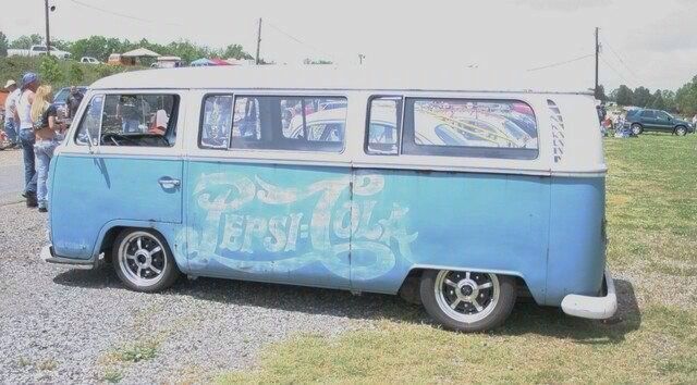

that's funny colby i guess my old bus ended up over your way. wish you had a pic of it.
Here you go

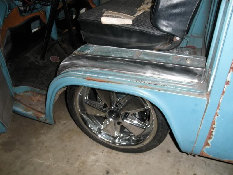

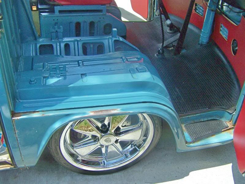

built some tubs last week thought i would share the results
Before height without the tubs
After the tubs
Image may have been reduced in size. Click image to view fullscreen.[/url]
