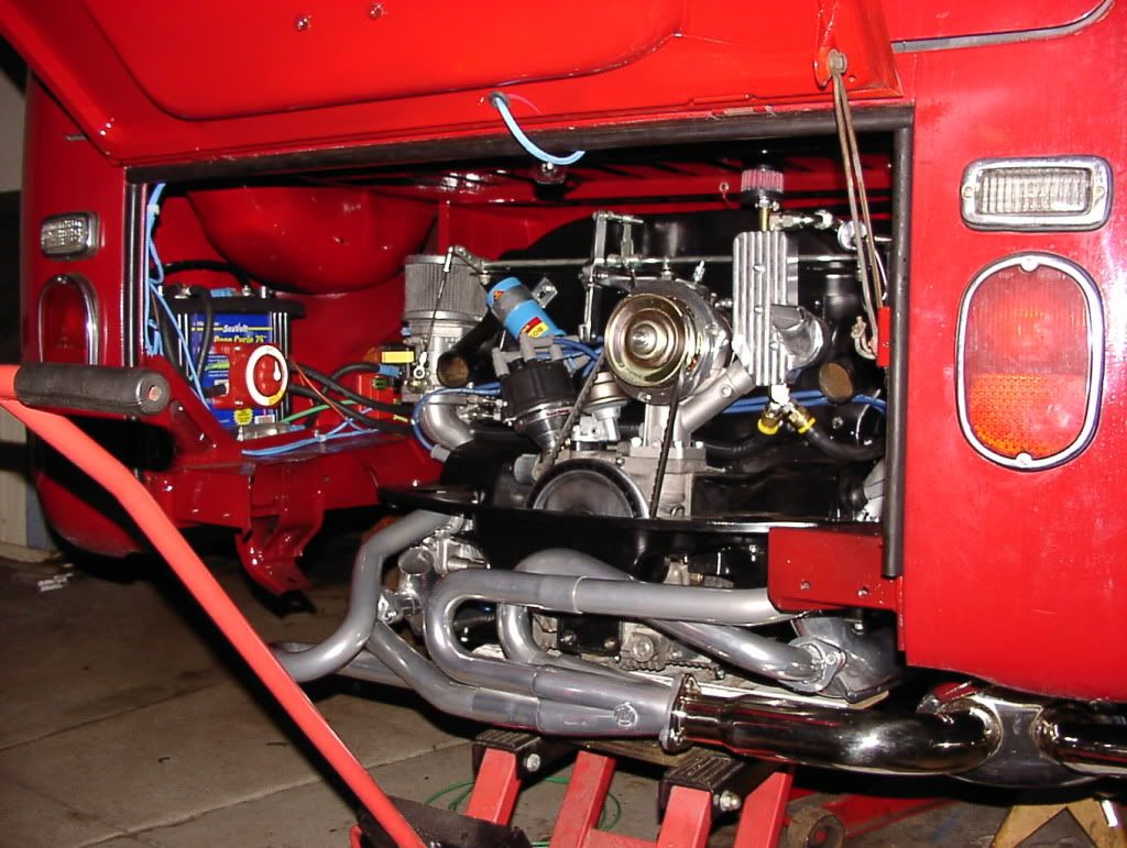

That said; I want to get something other than a floor jack to pull the engine this time. Does anyone have recomendations?? I've heard motorcycle stands work, but dunno?!? I've don't VW engines about 9 times in my life, and while relitively easy, I'm not the most experienced in this forum, but as I advance in age, I sure wouldn't mind making the job as easy as possible...

The Motorcycle jacks work fine. For a '69, a good floor jack is plenty though.
If you use a motorcycle jack, some people put a piece of wood across the two "arms" for better stability.

Your shift fork may be broken inside the bell housing. So, you say you're getting full travel on the arm but the pedal went to the floor? Only way to know is to pull the engine.
Jacks:
I use floor jacks and motorcycle jacks to pull bus engines. The problem with the motorcycle jack is that it doesn't go up as high as the floor jack. So, raise the rear of the bus up enough to get the rear wheels off. Then remove the rear bumper. When you get the engine onto the motorcycle jack (and plywood platform) you should be able to slide it right out the back.

I put a wooden cross brace on a small furniture dolly and used a regular floor jack. Best part is that the engine will be on wheels so it's easy to wheel around the garage nice it's out.

Here's a homemade dolly to wheel the engine around the garage. I've used it with wood blocks and wedges to pull and replace the engine, but a motorcycle jack would be far better and easier. There are big cracks in my working surface and the two large wheels did not get stuck in the cracks like a floor jack did.
