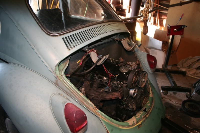

Ive had some people ask about my build so Im going to try to document as much as I can. had alot of photos on an old phone that was destroyed so there aren't many photos from the beginning. Started the build over the winter, was originally going to use a 1.6NA diesel, found a donor car with a 1.9TD so I changed my mind. Work was pretty limited due to not having a garage, moving etc. Finally have time to get back to it so hopefully I can have it on the road in a couple weeks. Used a Kennedy Adapter for upright vw motors, cars a 68

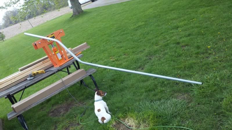

Working on the cooling, used a rabbit radiator
Made some pipes to run under the car and over the axles

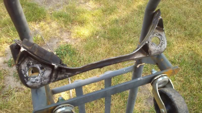

Took awhile for an update, wanted to get a second opinion on my rear mounts and bracing.
Started on modifying the trans mount, for those that don't know you can see the difference on each side
one side nearly done, it will make sense when you see the next part I have to make but I need to go buy a bigger drill bit first
all finished

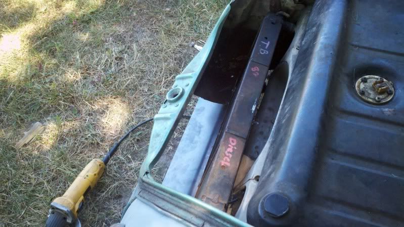

I didn't have a 1in drill bit so I had to wait until somebody could do it for me but you can get a basic idea of part of the bracing. As long as the weather cooperates I can finish it tomorrow. Running 2 pieces underneath from the trans mount (beefed up a little bit) to a crossbrace in the back. Mounts for the front of the motor will bolt onto the cross brace. If it all works it should stiffen it up and help support any extra weight. It will all fit behind the rear apron to keep a stock looking appearance
