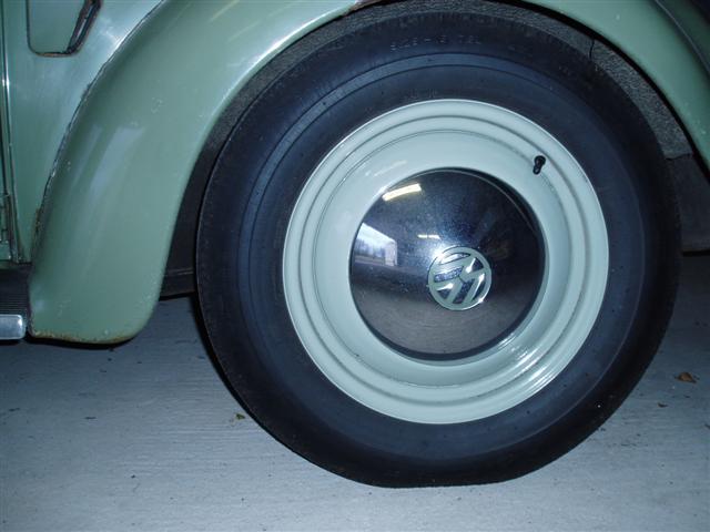

Here is my wheels. i don't know. I'm confused... that looks same color ? isn't it ?

my may 52 has solid light green colored wheels. not sure what that code would be. possible one year color?

Below is a picture of my Oct' 50 11G. It has L11 painted wheels, (just like the car) and I believe that's how they were painted on the 1950 sedans and went to 2-tone wheels in '51.

Im not buying the solid wheel color dropped by 1951. I've seen plenty of old 16" wheels dated 1952 that look just like the ones above (single color a little lighter then L11).
In the light resto I gave my split I searched for about a year for a source of info and finally found a 1959 Glasurit paint catalog at a automotive paint store in Phoenix that had been around since the 50's... is said, that 1952 Wheels were L16 Hellgrun (Light Green) and it stated in the comments section "1952 Wheel Color ONLY"
If you log onto the Glasurit (RM-BASF) site today it still says that. In fact its listed in It's Limco and was listed in it's UNO section when UNO was offered.
I mixed it up and sprayed it on the wheels and frankly it looks closer to what we have seen in previous threads of Auto shows and brochures of splits having single color wheels. Im not speaking for 50's and 51's... I don't know, but in July of 52' they were spraying them L16.
Here's mine with single color L16 Hellgrun wheels. (color is just slightly lighter than L11)
This pic below shows the contrast of colors a little better.

So the lighter green wheels would be a 52 thing... so for my 50 the same color L11 pastel green would be ok ?

I dont agree with this, seen -50 with this light green wheels also.

the wheels look to be medium green L13
