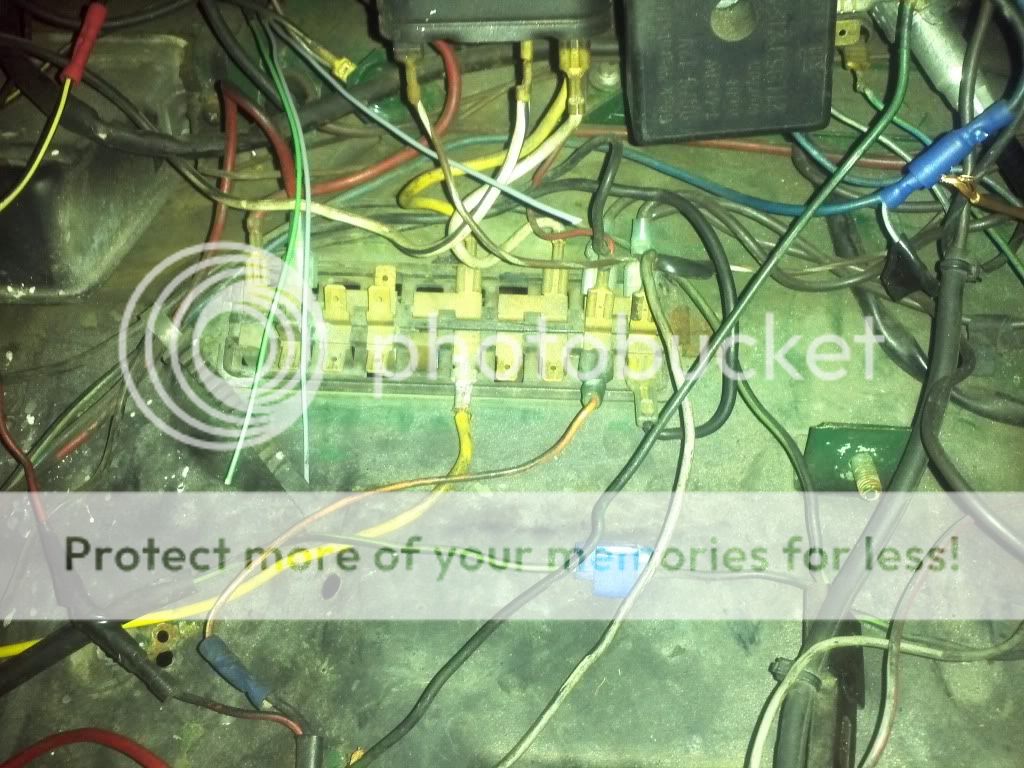

Okay im having some trouble trying to make my lights work,i just figure out the turn signals (front ones) back ones only work when i step on the brakes,i found the cables coming from the lights gray/black gray/red ithink and the diagram says it goes plugged somewhere but i have no idea where and a black and red cable,any help would be aprecciated

It looks like your wiring has been messed with big time, and it would be awful difficult for anybody on here to be able to decipher it.
Get some help from a Beetle person and try to return it to the stock wiring. Thats the best advice from here. Good luck

I just did all my wiring on my 68. I was too cheap to buy a new harness so i printed out a diagram and just followed every wire. it took probably 8 hours of thinking and drinking over a week to get all the lights working right.......but from your pictures your wires are messed up you should have a lot more plugged into the fuse box... you might want a new harness if your not good at figuring it out yourself

looks like 1/2 is missing
and those blue fuses are wrong an that fuse block is custom.
the rear wiring is under the tar boards. left and right ,and
revers is under the front board. and fuse for same.
the drawings in the TAB above, called Technical are dead accurate. for 68.

I kinda figured i have to rewire when isaw all those wires taped up lol but most of the wires are there,they just cutted like the tail light wires are cutted so idont know where they go,igot the head lights working and turnsignals,front ones(back only work when i hit the brake) brake lights work,so im guessing im buying me a 12 pack and figure out where they go lol
