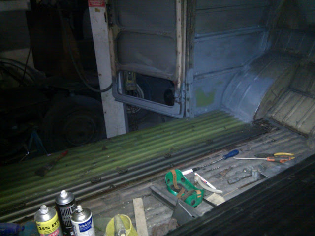

some more progress, this time I hit some major issues concerning metal fitting. B-pillar showd a totally wrong end curve so it need a major rework.
Outer rocker also was a bad fit and needs to be fixed from both ends (this is an early klassicfab part, so maybe it has been corrected)
cargo door was badly patched by PO, no prob, but I discovered that the bracket were the lower hinge is welded (riveted?) was unusable. Seems there is no direct replacement part...any ideas? (considering I am so bad making parts by myself Smile )
well after some rework I am very proud of the outer rocker result,
and patched the remaining floor using danish metal.

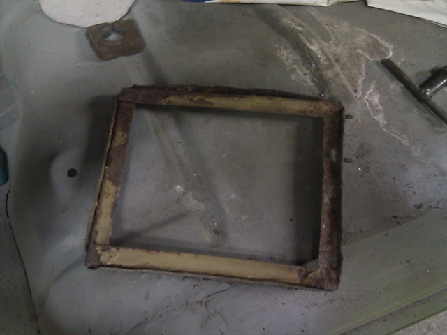

one interesting discovery, was to find that the gas faucet opening frame, was painted in westfalia brown. This and the fact that the gas hose was from year 1958, means that the SO23 gas fridge was NOT a hack, but installed in Westfalia factory. However is unknown if it was a customer special request or a prototype.
