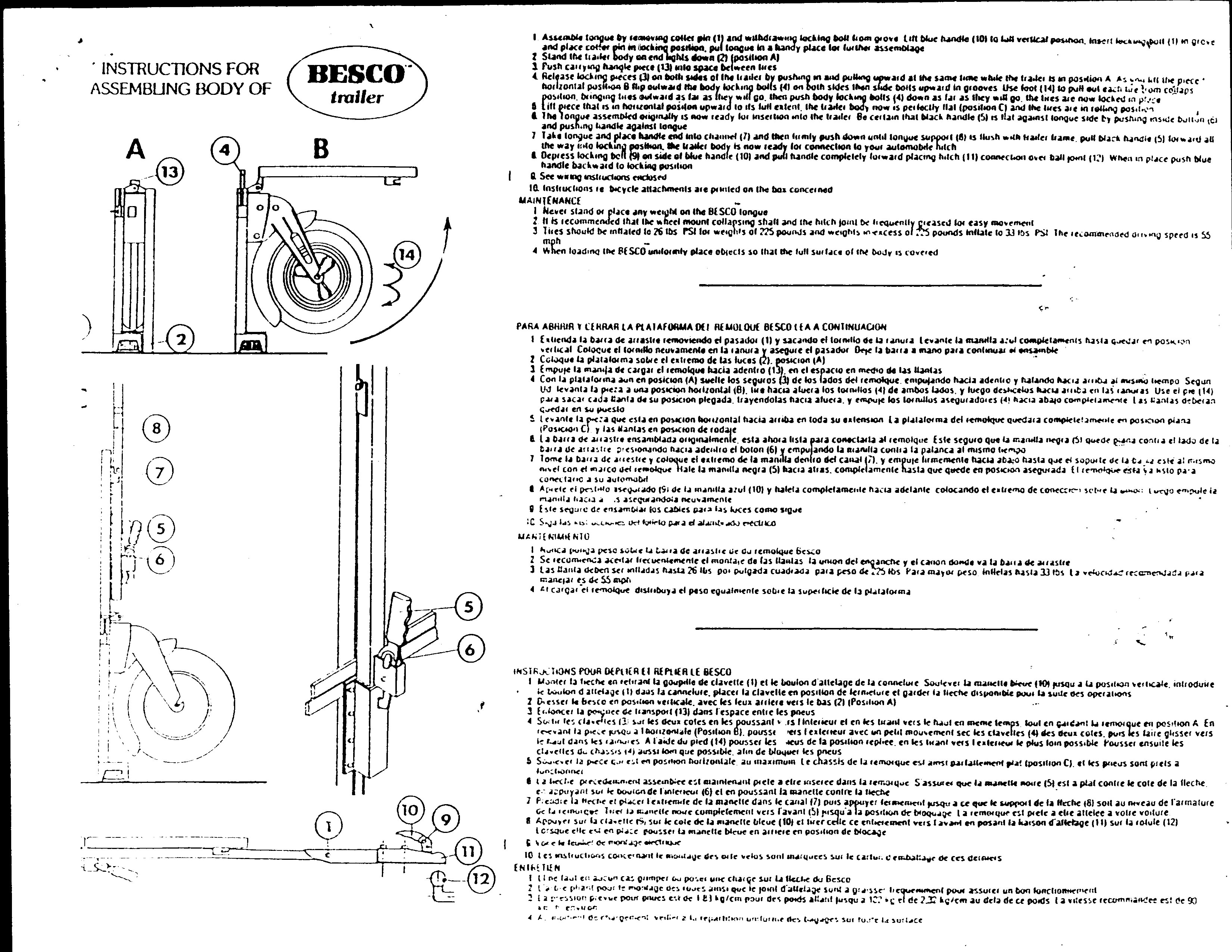

I found the original instruction manual. Five pages in JPG format. Enjoy.

Thanks for this! Some of it is impossible to read, but it is still invaluable.

I figured out all of it from those images, including the wiring. If you have any questions, holler.
