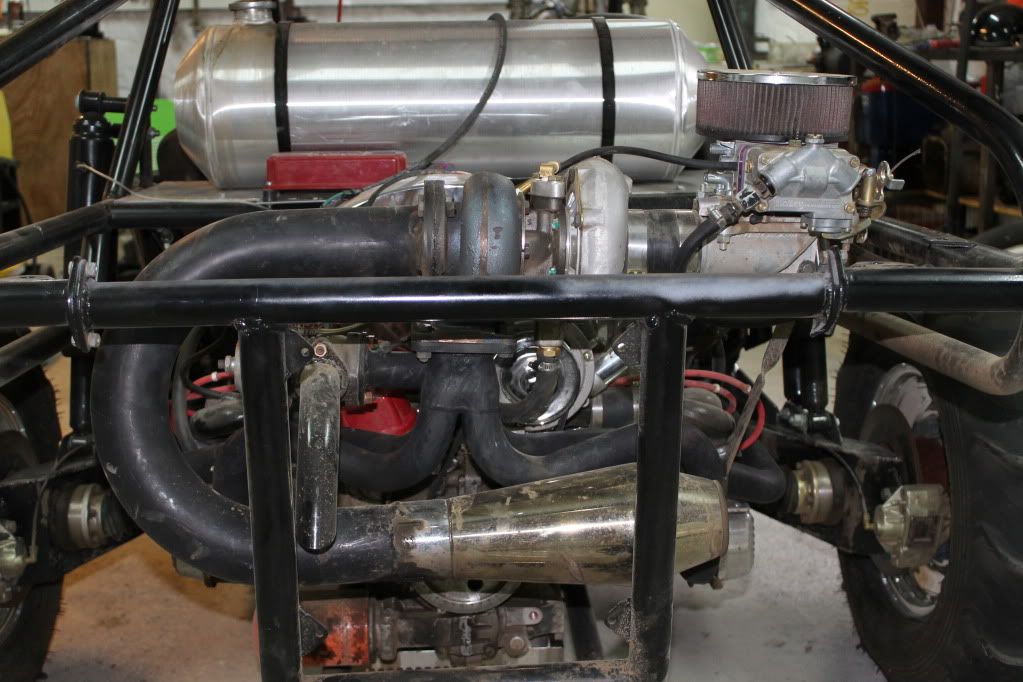

PostPosted: Mon Jul 09, 2012 8:04 pm    Post subject: Reply with quote
Here is a few pics for those interested.
SamT
Joined: April 17, 2009
Posts: 1122
Location: Kansas
SamT is offline

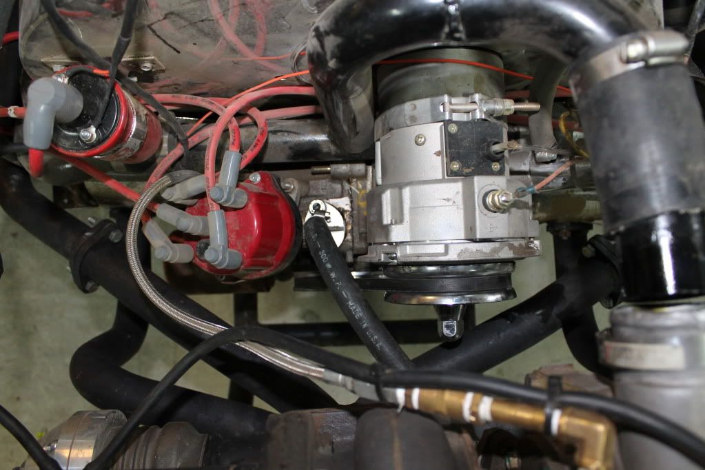

PostPosted: Mon Jul 09, 2012 8:07 pm    Post subject: Reply with quote
One more.
miniman82
Samba Swamp Donkey
Joined: March 22, 2005
Posts: 8835
Location: No F*uck Vagina
miniman82 is offline
PostPosted: Mon Jul 09, 2012 8:25 pm    Post subject: Reply with quote
Sweet, it's even got the same round 4-bolt dump pipe my turbo has. The one I would sell you is a direct bolt-in replacement. You need to contact your customer and find out exactly how he intends to drive this, as that will dictate how I build it.

Im waiting on customer and cb to sort out this turbo. I told him I have a line on more appropriate turbo for it.
See anything wrong with this setup? Would running the turbo with a 3/8 return for 5 min or so blow out the seals? Return is 1/2 with fittings drilled out some now.

PostPosted: Fri Jul 27, 2012 1:41 pm    Post subject: Reply with quote
Reading back thru this thread, you said "it appears to have a restrictor", is there a restrictor in the oil feed line? Without a restrictor you're pushing a lot of oil up there. If I remember correctly when we made the restrictor for our line it's only 3/64”.
Also, looking at the pics you posted, I’d move the oil feed line so it’s not laying on the turbo housing. You’re pre-heating hot oil…
And, you said “They were ran just a few minutes each before I put the larger return line on”. This doesn’t mean you ran them without the oil feed and return lines connected; did you?
