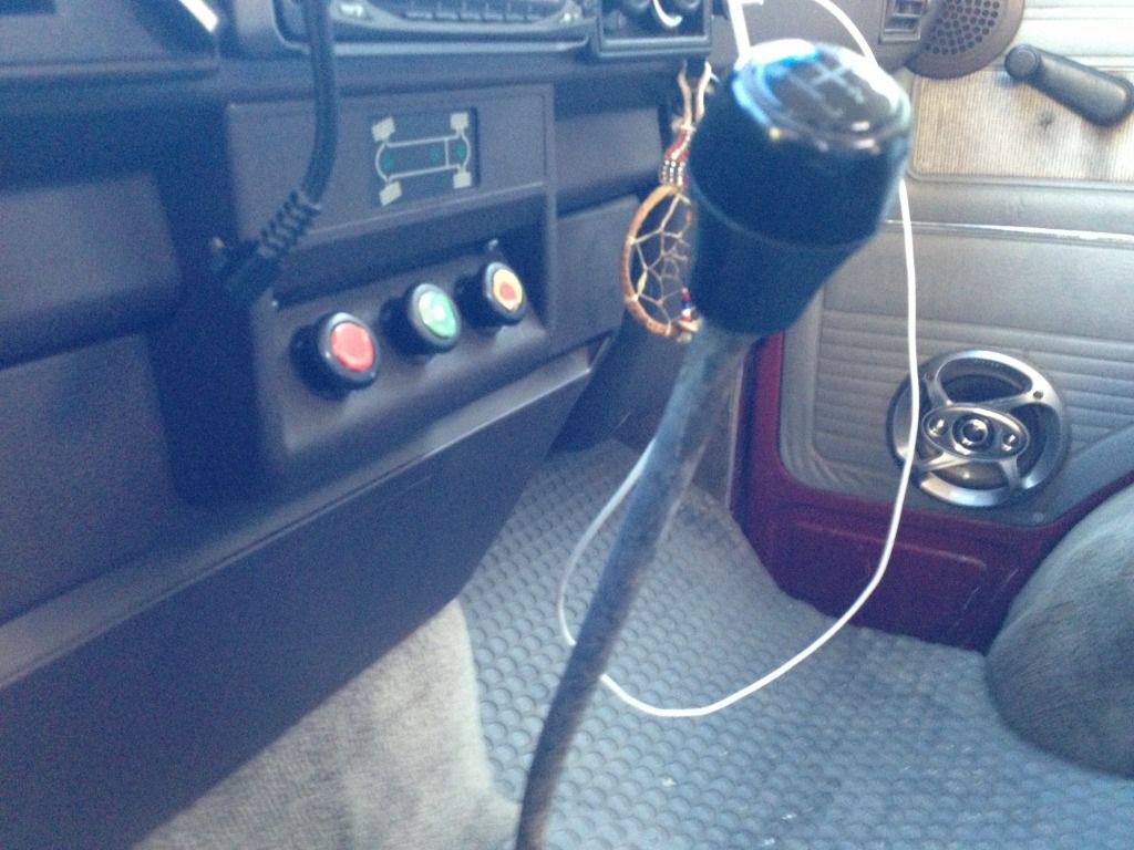

> The front locker is an upgrade with a go westy decoupler and solid shaft replacing the VC.
The first hint that you are not locked is if any of the 3 green lights do not turn on, on the locker control panel, when you pull the 3 knobs to engage.
Tranny Betty's 3 knobs unengaged, show me yours engaged:
Here is center diff engaged, see the light in the center of the control panel (ignore the slight glow on the front locker light, thats just spill over light from the illumination of the locker panel, my headlights are on, so my interior instrument cluster lights are on also. You can tell from the light on the heater controls)
My Soapboxes: Inflation; Handling; Gearing; Decoupling; Swepco
