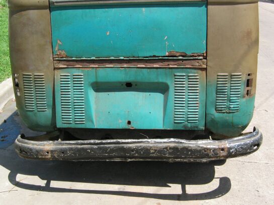

This vehicle was recently found in Argentina. It is supposed to be a 1951/52 barndoor ambulance (is there such a thing?). Owner mentions a 2-27 code, which according to him means ambulance (outfitted by Miessen). He also mentions the gas tank being to the left of the rear hatch, INSIDE the cargo area (!). That is all you need, to be picked by an ambulance because you are sick and be smelling gas fumes all the way to the hospital! Very Happy
Obviosuly, there are other non original aspects (such as the venting of the engine bay), but any information on the little information provided would be appreciated.

little small the door for a BD, no?

Back to the books. You really need to be a little more informed before commenting on this sort of stuff.

Wow, for once I agree with SHSC. Barndoor Ambos needed a rear hatch for getting the patient in and out. So a small engine lid was needed. Also, what's up with those louvers? Very 80s.

the piano hinge large rear hatch and small engine lid are what I have seen on BD ambos. does it also have the small top roof air scoop (NOT Behr) up front? I have seen them have fuel fillers on the right like non bds... do you have a VIN?
type 27 is ambulance
where's the brake light and taill lights?

Nice waste of a '58 decklid.

58's didn't have piano hinge.
And I think that decklids for BD trucks and ambulances were made from cut down treasure chest doors from the trucks. But I could be wrong about that.

Original BD ambulance....

No kidding, but wouldn't a BD decklid have a brakelight?

Decklids for barndoor trucks were made from cut down singlecab side doors.
The barndoor ambulance decklids were made from cut down barndoor decklids.
The rear apron is also special as well.
Here are a few more photos;
You can see that the VW coachwork on this model was pretty crude and that most of the special panels were handformed.
This particular bus is a '52 and I believe the VIN was around 24,000.
Here is a shot of the gas filler door;
It uses a barndoor ignition tumbler and key to lock it shut.

Wouldn't a BD decklid have a brakelight?
A.F.A.I.K., Yes. Maybe it was filled or maybe the decklid was changed but the hinge retained?

I thought they all had 'em too. If so, they did a pretty good job filling it in. It looks pretty smooth. The piano hinge on the decklid looks a lot different than the rear hatch one.
I'll take a run out to the yard and take a look at mine and let you all know. LOL

Well, it looks like it is a BD deck lid. I didn't notice the stamps going all the way to the bottom edge. Strange that they filled in the brake light though, but then again they did louver the hell out of it.

i thought the miesen built amublances kept the barn door engine lid?

Notice how the recess on a barndoor ambulance engine lid goes all the way to the bottom edge, where as a 55-(early) 58 lid the recess stops short of the bottom? They cut down the og lid as the guys above said.
