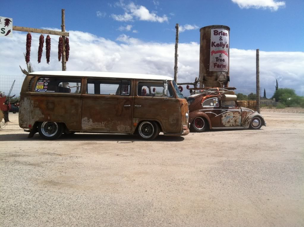

Here's my 68 and 61 Bug

^ I am in port richey, fl. I just have a random collection of out of state tags that I keep around for emergency metal patches lol. Whats the set-up/specs on the '68? Looks good!

Ahhhh...gotcha. The 68 has a 4" narrowed scratch built beam by me and a friend. Rear has 4.5" drop plates and is currently getting notched.
