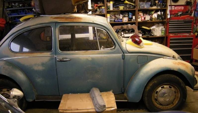

The rebuild begins on a 1970 vw bug. Time to as I do the rebuild remember my college days of pack as many of us in a bug that we could. "Pass the hat" for all the change we could pool together - for a couple of dollars we had more than enough gas money to travel anywhere we wanted. Head off on an adventure for the weekend, just to get away for a while.
The days of painting yellow flowers on the trunk and hood of my old bug, done out on the soccer field. Driving the northeast winters, with an ice scraper in one hand, one hand on the steering wheel and a blanket covering my legs to hold in what body heat I could. Traveled down route 17 - during then it was under construction, most of the way were "forced" to travel the local 2 lane roads. Knowing that when the old AM radio could finally pick up WABC and Cousin Bruce I was getting closer to NYC!
All those images, and more, come back as I look at my new project in the garage!

Original paint was the tan over which sometime in it's life it was repainted blue hence the Patina look!
BUT soon to be a new bright Yellow Bug.
All new tires have just arrived, and the first large box of rubber moldings.

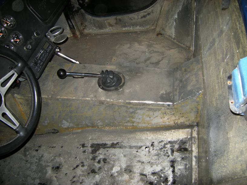

in the cleanup and removing of all the stuff in the car found that it does have one tiny... little hole in the floor!

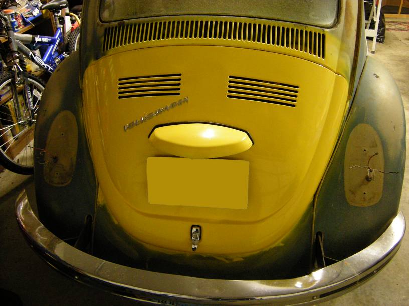

I have a complete 73 bug engine on the way to give the old bug a "heart" & "lungs". Cleaned up the rims and new tires all around - that left me with the Patina look color to do something about! I have a large compressor and a good paint gun BUT I had been reading on "paint your car with a roller"! If you have not read up on this system here is just one of the many links on the internet for it: Roller Paint your Car
Any one here try it? I figured take one of the smaller panels, strip it down and give it a try. Took the engine cover as the place to give it a try. Found the color the wife loved at Home Depot, a bright yellow. Rollered the paint on really thin, many coats later and a buffing down ... you want to see how it came out?

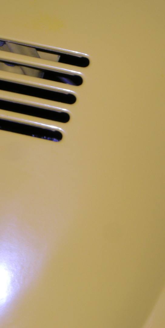

and a close up of the rolled on paint
It seems to be working ok. Not sure how well the paint will hold up so was wondering about others that may have tried it.
It's nice that you can paint and not worry about covering up everything in the shop to keep from getting a thin paint coat on everything if you were using a gun.

The paint they suggest using is Rustoleum - an oil-based enamel paint. Which is the paint I tried using with Mineral spirits to thin it.
I was kind of nervous about doing it but figured if it look like junk I could just strip it off and repaint the car the current conventional way.
To my surprise it seems to be working. It is really glossy after I went over it with a DA buffer - wool pad then used a foam pad. I'm using Meguiars polishes which may help. It sure does look shinny!!

great job, what grit did you use to DA with? they make something called finishing film for the DA that i would like to try. i have Rustoleum rattlecanned a couple of offroad cars and they faded in the sun. the roll on might be a little different. i might suggest a cheap Ebay style enamel clear coat to put over it when you are done rolling it and sanding it. duplicolor has a quart can of spray on enamel clear you could test try. no mixing needed. you can pick it up at most auto parts stores that sale paint and it is about 20 bucks. we used the duplicolor clear on this manx and it has held up good.
the great thing about using roll on is that it will be easy to touch up.

More progress - slow as I disassemble parts so that I can apply the paint easier. I take one section apart at a time, sand, prep and roller the paint on. This next week I pickup the 1973 complete engine that has been stored ready to go. We bench started it and it runs great with good compression all around. Soon we'll be able to move the car as needed while we keep working along on this roller paint project!

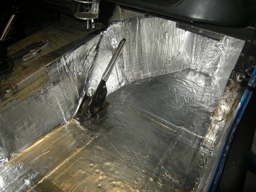

PostPosted: Mon Jul 06, 2009 8:18 pm    Post subject: Use of SecondSkin products in a Bug? Reply with quote
I have just finished sound deadening a big V8 powered open top 2 seater sport car with SecondSkin's Damplifier pads and their Luxury Liner Pro pads! Using a sound meter found that it actually works.... SOOOO sitting just to the side of my car is my wife's project! The 1970 bug that we're reassembling, painting, as well as adding a little sound deadening! I see they advertise here, as a vendor, have many of you used their Damplifier mats, Spectrum coatings, or the Luxury Liner pads?
Our plan is to start from the back and put the Damplifier pads and/or Spectrum coatings under the carpet all the way up to the front of the car. On my other car not only did the Damplifier pads dampen the sound down but also sealed up the aluminum panels that formed the foot boxes and floor of my car. Those Damplifier pads are super sticky and can stick even if the surface is less that perfect.
This is what we did:
Bare aluminum floors just a stiff brush gone over it all to clean off the loose stuff...
And after covering it with Damplifier pads
If we use the Damplifier pads and the Spectrum coating on all the interior metal ....it should work even better for an enclosed bug compared to an open top car.
