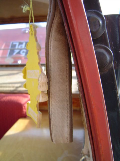

RockStock
Joined: November 26, 2004
Posts: 2585
Location: England
RockStock is offline
PostPosted: Fri Aug 25, 2006 9:55 am    Post subject: Reply with quote
Anchovy wrote:
For a long time it was generally accepted that the assist straps were made from a different material than the headliners. This was misunderstood because the assist straps had all the soft fibers removed from years of handling which exposed the underlying weave....this presented a coarse grain weave that appeared to be a different material
sounds like a nice excuse to use a pic of the grab handle from RJs 54 dlx..
-StockRocks-
Anchovy
Joined: August 05, 2000
Posts: 2493
Location: San Diego, CA
Anchovy is offline
PostPosted: Fri Aug 25, 2006 10:51 am    Post subject: Reply with quote
RockStock,
That photo is a good example of the assist strap. You can see that the top portion still has a lot of "fuzz" while the business end has worn down to the base fabric.
I also notice that the yellow "pine tree" air freshener is not original. Everyone knows that BD's came with green "pine trees" from the factory.
