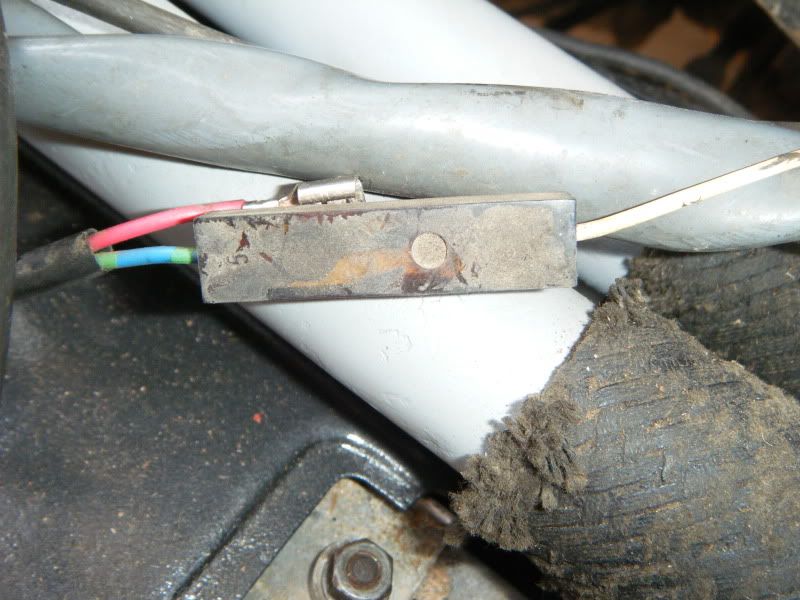

Checked it. It comes in around 650 K ohm Which is nowhere near the spec, but is what is measured new, and worked fine up till now.
Also, bypassing that sensor and using a 100 ohm resistor instead does not change the way it's running.
moving the FI harness near the baro sensor, or moving the sensor itsself sometimes changes how the engine runs. I inspected all connections in the area, then I pulled the harness out, slit it open inspected it real closely, and started ohming individual wires while doing the wiggle test. So far, all the wires look excellent and no results. Still runs like puke.
I'm leaning towards a bum baro sensor.

CHT is new? Check it anyways.

You've got wire 19 hooked up to the wire that goes to the oil send unit. It should go to a wire that comes from terminal 85 on the pump relay. Look at that wire on the relay. Is it red? If so, disconnect it and check continuity on the red wire next to the blue green one you're hooked to through to the end of the wire that you just took off Terminal 85 at the pump relay. The pump relay is the one up under the dash.
If you have continuity on that wire front to rear, plug the front back on Terminal 85 and hook the rear to Wire 19. Put the blue green on the oil sender where it belongs.

marchi wrote:
ok swapped that wire, im a dumbing i have the schematic hanging on the wall and was looking at it earlier. I still have no fuel pump by key pretty sure the relay is bad, no clicking at all but the back seat clicks on key turn. but when i jump the pump relay so it runs continuos i still get crank but no run. how do i check injectors for pulse?
Put your foot on the accel and try it. Could be the throttle sensor is out of whack.
As to the pump- no- run issue, look here for how to trace the wires from the main power relay to the FP relay:
http://www.thesamba.com/vw/forum/viewtopic.php?p=6077360#6077360

If you test out the relay and it all comes back good, and you don't have any signal to the relay from the ECU, I was able to repair mine.
I opened up the ECU, on the board near the main harness connector there is a transistor that is for the pump. It looks like a small silver can wearing a crown. It's the only transistor on the board with a heat sinc (Ring of metal with tabs off the top for cooling) under the can, where the pins go into the board there is a disc of foam rubber (Also the only transistor on the board with that feature). On mine, the rubber had held moisture and corroded the pins off the transistor. When I touched the component it about fell of in my hand.
I was able to clean it up and repair the pins with solder. My fuel pump had worked perfectly ever since.
