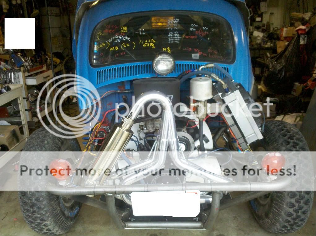

Adrenaline Junky wrote:
Hi Ed,
I used this radiator from summit http://www.summitracing.com/parts/SUM-380325
It fit well and the hoses lined up nicely. Found some off the shelf hoses at autozone with the exact size ends that fit like a glove.
I bent up a coat hanger and took it to AZ to find the hoses. I was stoked that I found "exactly" what I needed. The wife coulldn't understand why I was so excited about rubber hoses....
thanks for advice, I looked it up and it looks nice like the rest of your project.
For your engine mount did you just use the mounting points below the belts alone or did you catch any points on the side of the block??
I fill fortunate to be able to work off some of the things you did, even with that said many things will fall in place in a differant pattern. My boy is really trying to get me to spend the extra for the rear coil overs so we wont have to do a redo. I will keep my eyes open for some used good ones, I don't have the money to put out like he did for that build. keep up the good work ED
Hi Ed,
This is what we are starting with and not much will be used other then the roll cage, frame and body, engine, adaptor, and wiring, not sure even about the pressure plate it seems to chatter and lot and is 1700 lbs which is the low end for the one they sell at kennedy, do you know what pressure plate you used and pressure.
I even have a new wide eye one piece front end and will take all the remaining good parts and put on another bug I have to resell.
