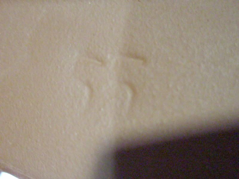

Here is a "55" stamp on my Jan 30th 1958. The 30th was a Thursday, not sure if VW started the work week on a Sunday, if so Thursday is the 5th day? There is also the letter "B" to the left of the 55?
[img]Image may have been reduced in size. Click image to view fullscreen.[/quote]

I have started a list of the Splits/Ovals/post 57's, to try and find a correlation on the Stamp#'s?
