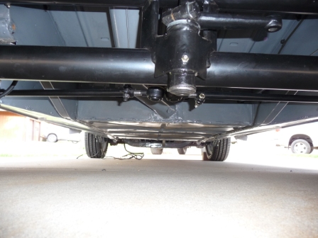

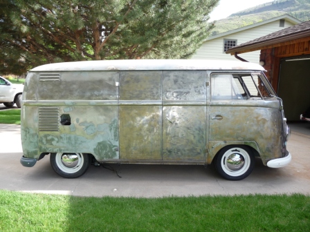

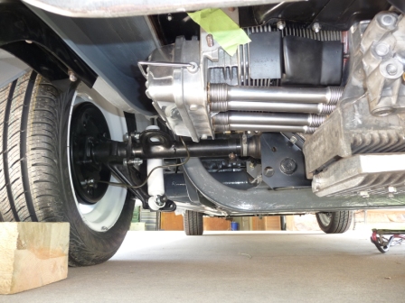

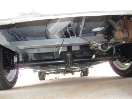

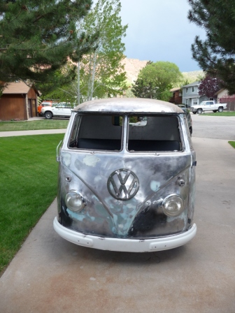

Update. Hopefully I will have it out to paint next month. Installed 4 inch beam, rebuilt all brakes, stock bus upfront with type three in the rear. Installed bay master cylinder. Pine built trans, bug tunnel with 4:12. Installed type three long axles with wagens west offset adjustable spring plates. Installed the bus boys trans adapter, got repo later bus nosecone with hockey stick shaved the reverse light switch and installed. Stock wheels with 185/60's in the rear and 175/55's up front on crows feet. Rear wheels have .75 inch spacers and will use mercedes Binz 300sl Lug bolts. Sanded and Por 15ed the under carriage.
Built a stroker motor. 78.4x90.5 with 7.9:1 compression ratio. 042 heads with solid shaft rockers and swivle feet adjusters. Engle 100 cam with stock flywheel, deep sump and 40 Kadrons.
Rebuilt my crappy seat frame, replaced about 100 springs and had to reweld a bunch of the frame. Installed a WWC seat cover and used the horse hair padding.
I finished all of the metal work and am now starting on the body work. Have all of my parts purchased and all I need left is finish bodywork, paint and chrome work done.

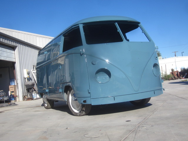

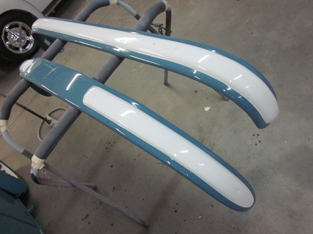

PostPosted: Thu Sep 23, 2010 10:31 am    Post subject: Reply with quote
It is getting there. Just have to start assembly now. Very Happy
