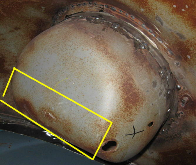

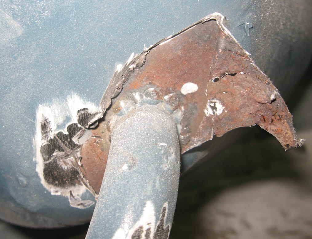

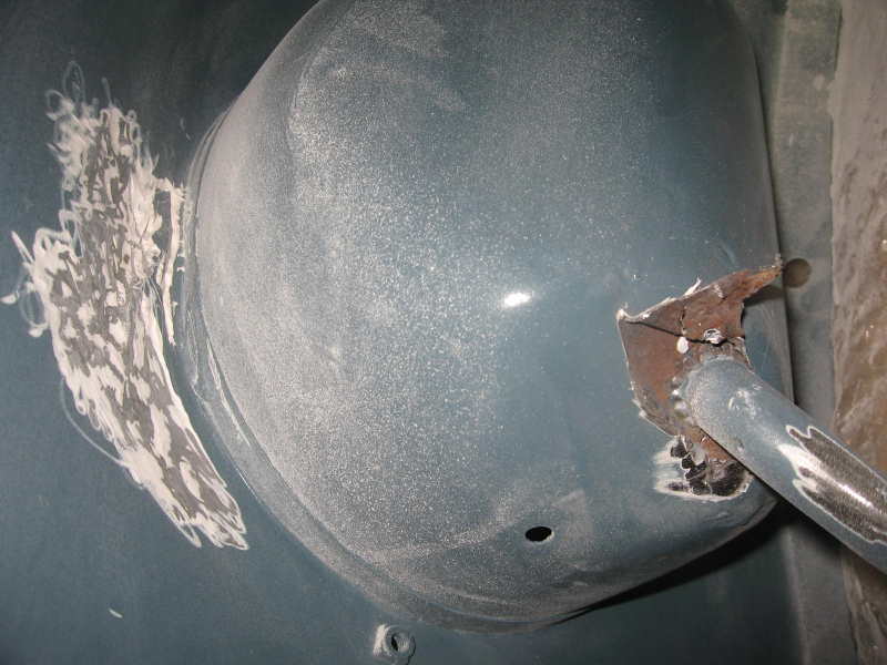

Here are some pictures of this "same" fender after it received a top Eur treatment here in Belgium. The deal was a split horn opening (provided an original patch), new cable conduit (provided one from Wolf) and a back yard painting that would fit the patina of the rest of the car.
After some excavations on the mysterious new double patch in the solid lamp bucket and a suspicious hump in an area that had no rust at all here are the results...
My point of posting this is actually related to the special design of these early fenders; if you ever find one do not let it out of your sight.
