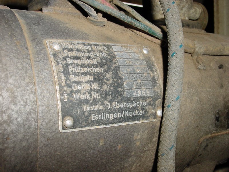

does anyone know what model would have come in a 57 standard?
perello
Joined: April 15, 2005
Posts: 544
Location: were social security comes for free
perello is offline
PostPosted: Fri Feb 15, 2008 1:31 am    Post subject: Reply with quote
AFAIK should be pretty similar to this one I am restoring
mine was labeled as model 58-59
Posts: 53946
Location: Phoenix, AZ
PostPosted: Fri Feb 15, 2008 9:10 am    Post subject: Reply with quote
Here's one from my ex-'58 Standard
