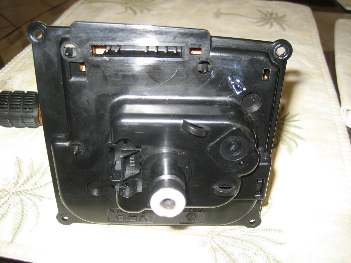

Thanks to the link from VW vortex for this fix, though I'd share & it was relatively easy.
1) Remove intrument cluster & have a clean clear place to work. The speedometer has a plug that connects to the blue tape on the back of the cluster. ( I didn't know that at first). Use a small screwdriver to pry it up. & carefully pull the tape from the speedo. 3 tabs. Unscrew 4 screws that hold it in place. Remove speedo.

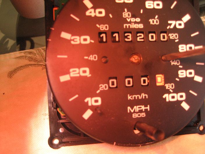

2) Once removed, carefully move needle past the stop and to the mark on the speedo head.( small car instructions). carefully pull needle from sppedo.
3) Remove screws from Speedo face plate. (this is when i put my white guages on)
4) Once the face is off, you can see all the gears, if the gray metal one furthest to the right spins, the miles will roll too. I read that a good odometer won't turn and the gears are pressed on to the the shaft. Mine was spinning., the other gear, furthest to the left , may spin also if broken, that one was OK. Remove the 4 screws that hold the plastic cover to the casing. this will loosen everything up enough to work on it.
5) Turn speedo on its side gently slide the shaft just past the metal gear & the gear will come free. Don't go too far or the the other numbered gears will come off too & I'm pretty sure you don't want that to happen. I used a toothpick & a few drops of epoxy on the inside of the gear, put it back in place & lined the shaft back up & pushed it back in place. let it dry & re-assembled everything.
6) While this was out, I applied my white guages & installed blue LED's where I could. Test drove & the odemeter is working & I like the new look of the cluster.

Raynor or anyone who has done this
RE: The speedometer has a plug that connects to the blue tape on the back of the cluster. ( I didn't know that at first). Use a small screwdriver to pry it up. & carefully pull the tape from the speedo. 3 tabs.
There are 6 silver contact points on the blue electrical ribbon you reference. It looks like they just stick through the blue ribbon. Do I just pull the blue ribbon away from them, and when I put the ribbon back just press down around them?
RE: Turn speedo on its side gently slide the shaft just past the metal gear & the gear will come free. Don't go too far or the the other numbered gears will come off too & I'm pretty sure you don't want that to happen. I used a toothpick & a few drops of epoxy on the inside of the gear, ...
If I understand what you wrote, the metal gear should not be spinning on the shaft. So after getting the shaft to stick out of the siding, use a toothpick to place a bit of epoxy on the inside of the gear.
Is this correct?
Thanks much. I've been riding without an odometer for too long.

jdbs3- on the sivler connectors, it is a plug that pulls away from the speedo, just be careful not to damage the blue strip.
correct- the gray gear should not spin at all. As i understand it, that is what causes the speedo not to engage and work properly.

RE: 2) Once removed, carefully move needle past the stop and to the mark on the speedo head.( small car instructions). carefully pull needle from sppedo.
Thanks for the last feedback. For the silver connectors, I got the plug out by using a small screwdriver and tweezers. I've moved the needle past the stop to the mark.
But I am not having any luck getting the needle off. It is stuck fast.
Any thoughts?

Small car says to use two spoons. I just got my finger nails under ther and pulled up.. Be careful here, the needle will break. Take your time & give it a good upward pull. It'll come off.

Courtesy of luvdavdubs: use a fork.
Haven't tried it myself.

I was explaining how I had repaired my odometer on my 84 Vanagon to a friend by taking it apart and putting it back together. His reaction was "That's illegal". i corrected him by pointing out that if I lowered the number and tried to sell the van as a low mileage van, then that would be illegal, but when the miles showing after repair exceed 214,000, low mileage is not in the discussion at sale time. Very Happy

I saw a write up where the gray gear was removed and placed flat on the bench and a small phillips screw driver placed in the center of the gear and then struck with a hammer, on both sides to make four little burs on the center of the gear, then the shaft was forced into the center of the gear, causing the burs to bite into the shaft. I've tried this and it has worked for 1000s of miles. The write up said that the epoxy or JB weld had failed after a short while.
http://www.twistedlimbpaper.com/brian/vanagon/Odometer.htm

Yeah, it'll work for thousands of miles. I've tried every method of fixing that gear to the shaft save a roll-pin; knurling, super glue, you name it. They've all worked for thousands of miles, usually a year or two, or even more. And then the thing just stops again, and you open it up and the shaft has walked on out the side again just as it always does.
When you add a hard physical stop to the end where it walks out, it makes it impossible for it to move in that direction again.
How long has my stop-fix been on there? Well, uh, thousands of miles (couple years now). So far so good, is all I can say.
