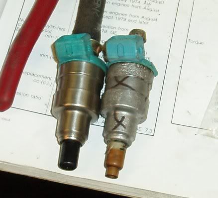

I'm also wondering if I've ordered the correct injector. The new one has the black tip. The original is (dirty)white. Same thing?

The pintle guards on the injectors come in many different colors and obviously a few shapes too, don't worry about it, it's there to protect the internal parts but does nothing to the performance of the unit.

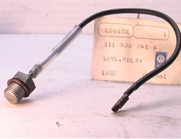

Thanks! So there are two temp sensors? The reason the sensor won't fit is that it's just slightly too big. I got it from bus depot.
Looks similar to this one...

That's the one, and it should fit.
You only need one sensor, the other head is probably a symmetrical replacement with the hole in it just for the hell of it. The theads are 10mmX1.0, you may have to clean them up with a tap.
