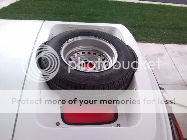

Well, here's another mod to check off of my list:
My wife hates it, my neighbor hates it, but I love it. I'll admit, cutting up my luggage rack took more chutzpah then I normally carry with me but I did it for two reasons: I feel spare tires mounted to nose is dangerous to my knees (I'm 6'7"), and I never was crazy about the appearance.
Because my bus is a Riviera conversion, its luggage rack is fairly deep. When the tire lays down flat inside, you can just barely notice that it is there.
It's mounted via stainless steel nuts that I JB Welded to the roof.
The nose mount needed some elevation so I found some new fuel line to act as bushings/spacers.
My OTHER neighbor had some of this U-Channel edging lying around which worked perfectly to dress up and protect the new shape of the luggage rack.
So now, I have a clean nose onto which I'll place a VW emblem.

I like it!, but those JB welded mounts do nothing for me, you're entirely counting on how well the paint is stuck to the roof, could end badly. I'd run a couple of bungees over it for insurance myself, or a hinged metal strap with a safety pin or bolt on the loose end.

I think that I was more optimistic about JB Weld then realistic. In hindsight, I agree that there are better options. I kind of like your strap idea. In the meantime, the tire is fitted moderately tight in its home.

Certainly a great looking install. My concern would be the weight of the tire on the roof in a central point, instead of spread out over a larger area...along with the JBWeld. But, it does look clean.

Not because of any great engineering on my part, but by chance, the tire does not rest its weight on the mount. The entire weight of the tire is on borne by the luggage rack/roof. The mount just keeps the tire down. I had the same concern as you about denting my roof with weight of the tire which is kind of why I liked using the fuel line as a spacer/bushing.

that looks good overall. I've been trying to come up with some place to put a spare for my riviera conversion. I don't want to hang anything off the nose of my bus. The shape of your cut out is probobly enough to keep the tire secure. I'd find a cargo net out of an suv in the bone yard and cut it down to fit your footman loops in the rack.

I have been wanting to get my spare off of the front of my bus and I really like how it turned out for you though I think I would go with cargo straps hooked to re-inforced footman loops. That is a great inovation!

Thanks, but I can't take credit for the idea. If I was to do it again, I would not have cut out the base of the luggage rack but just the sides to the fit the tire. Holding it down with the footman loops would have probably worked just fine.

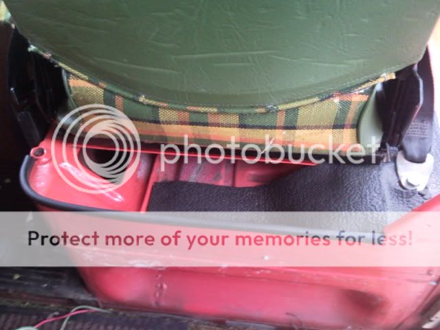

And hey, since I've dusted off this thread, let me show you what else I've been up to:
I cut out my passenger bulkhead and had a swivel seat base and the triangle gusset welded in. Over the winter I repadded a set of late Westy seats to install. Now I have a swivel seat and more importantly, extra seating room for my four-person family.
