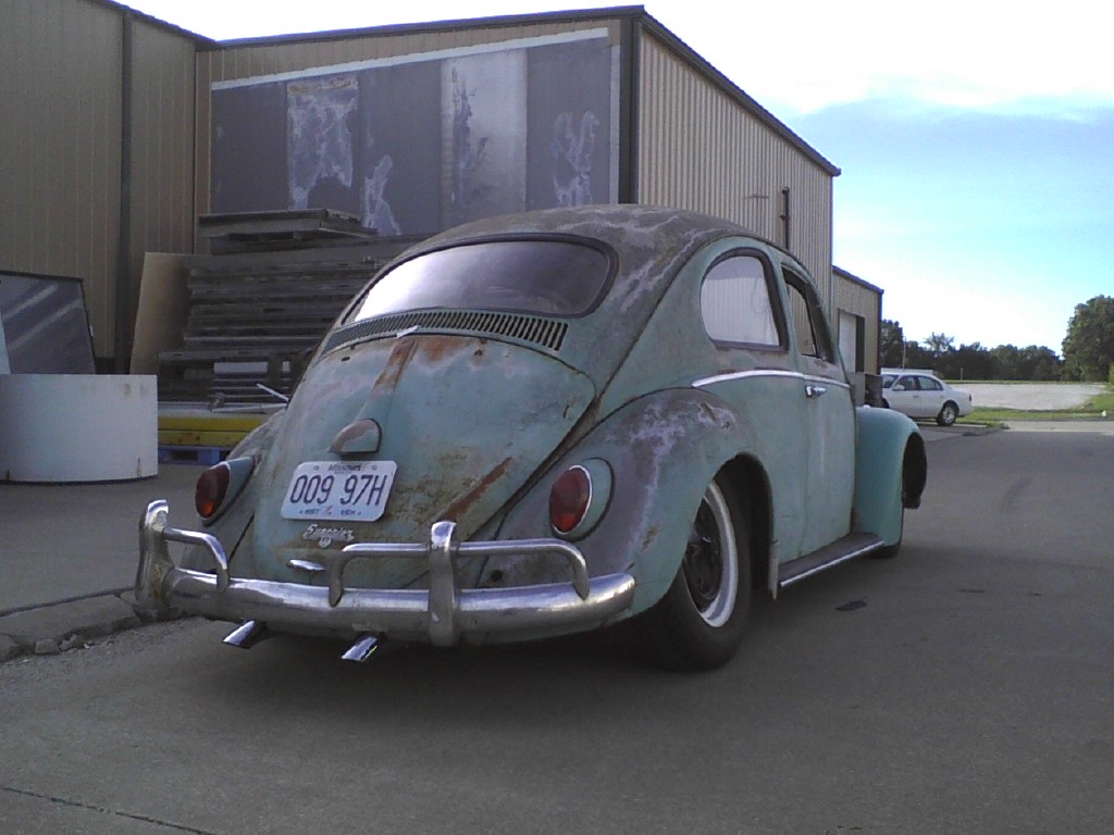

So today was the Maiden Voyage for the Turdkis "suction cup" bug.
Got a reman Bosch starter from the local VW guy. It spins nice...and works every time.
I replaced my leaky fuel pump, did a little carb tweaking. Daniel came over and helped get that pesky passenger running board on. Then I hopped on Geico, got some insurance, and we headed to the local gas station, a couple of miles down the road.
I guess my rudimentary alignment worked ok. Handled well except for the steering box is a bit loose. Didn't notice any bump steer.
I think the H30/31 and 010 combo will work well, except that I might need to experiment with the jets a little. When cruising at speed, it runs a bit rough, but when I gas it, it goes. Might experiment with the timing a bit, too.
Anyway, first run sucessful!

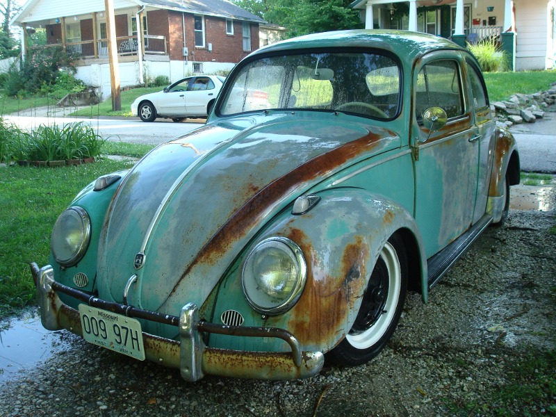

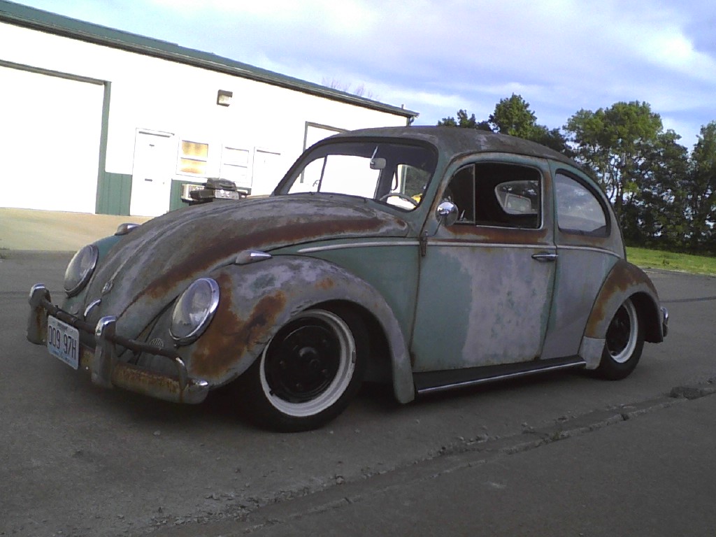

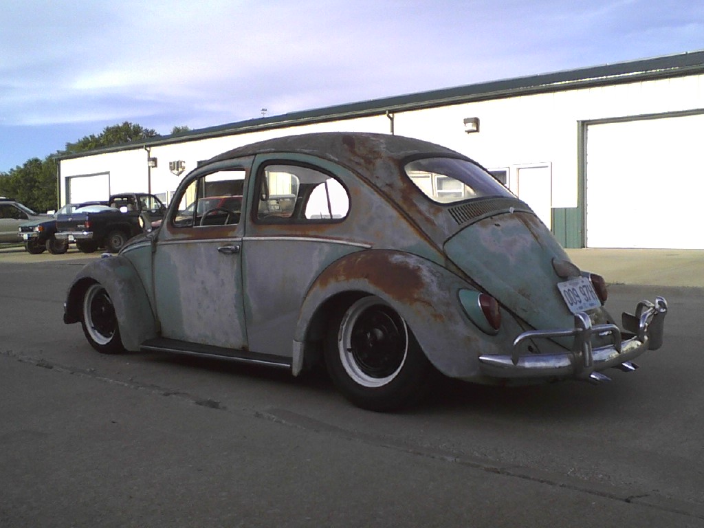

So here it is. Today I got the back bumper on, and finished up a bunch of other stuff. I still haven't washed all the black crap off from it being stored in the woods.
I was a worthy goal, but I won't be driving it to Springfield Friday. The steering box is toast, and adjusting it does not help. I have a little over 1/8 of a turn of play in the steering wheel before the front wheels react at all. My first few test drives were on nice straight road and it was no problem. But combine a worn out steering box with a bit of bump steer and curvy roads...not safe.
Oh well.

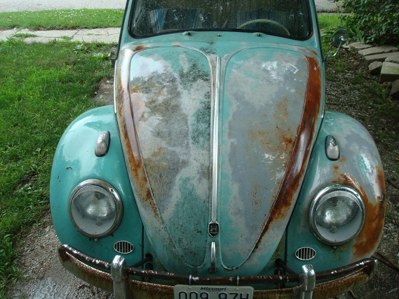

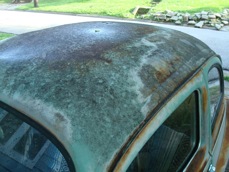

So I finally got a chance in between storms yesterday to scrub the moss/lichens/woods skank off the bug. I started with scotch brite pads, but ended up using #0000 steel wool just to cut through it.
Half the hood scrubbed:
Roof before:
Afters:
Of course it dulled up a bit when it dried, but I might try buffing it out a bit, and maybe some CLR and fine sandpaper on the roof.
