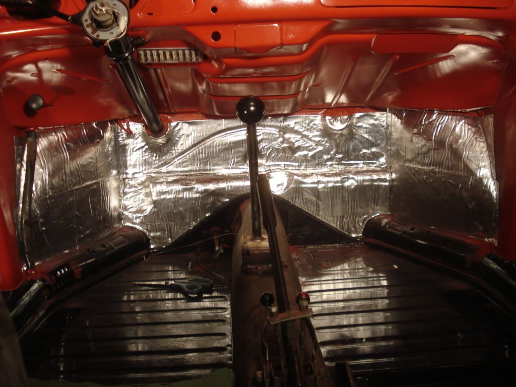

iaccy wrote:
Quick Roof from Home Depot, $16 a roll...25'x6" This is exactly how much one roll gets you
Sound deadening tool I made from an old rollerblade wheel to stick the stuff in the nooks and crannies. It worked awesome Very Happy
I really really like this... I have a few questions Smile
Is Quick Roof something people usually put on their car this way? Any additional details about this product, and how you used it, perhaps gotchas, things to watch for?
Also do replacement carpets/mats cover all that shiny surface well (and/or can it be painted)?
Thank you Smile
L331 Horizon Blue January 1957 Canadian Deluxe Oval Beetle

People usually put stuff called Dynamat down. It's used by a lot of car restoration guys and sound system installers to keep the car insulated and the road noise down. Quick Roof is basically the same thing just wayyy more affordable. You can watch this video from youtube about it.
http://www.youtube.com/watch?v=u7eIF4cgFx4
There's really no tricks or surprises. Just make sure you stick it where you want it, b/c it's really hard to peel back up once it's stuck. I heated up the Quick Roof and the area where I was sticking it when I was installing it. this way it makes the roll pliable and easy to work with. Just be careful not to cut yourself the foil edges can be sharp.
I'm sure you can paint it, but I don't think it's necessary b/c the carpeting covers everything. Hope that helps.

That helped a lot - I love Chris Vallone's videos!
Would one stick that on the floor pans too? Chris mentions that he is going to use it in the doors under the panels.
Thanks

yea you can put it on the floors if you want. But if you want to do it the original way you can buy the tarboard like how it came from the factory.
http://www.wolfsburgwest.com/cart/DetailsList.cfm?ID=113863740
If you want to put stuff on the floor, I'd just use the Quick Roof in stead of buying that.
