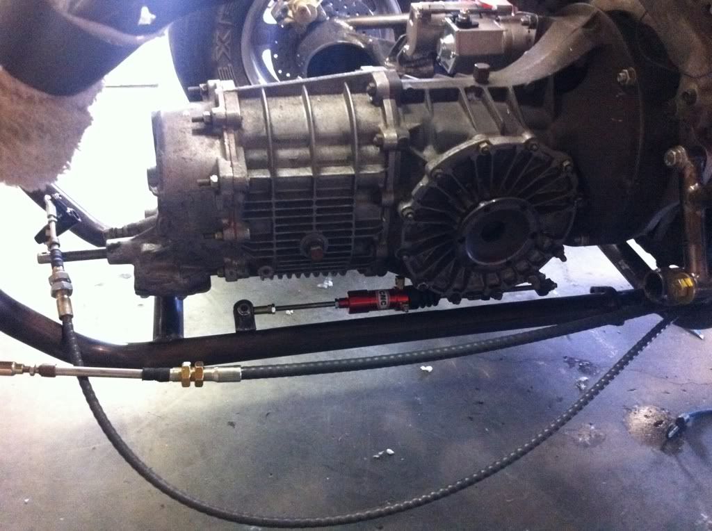

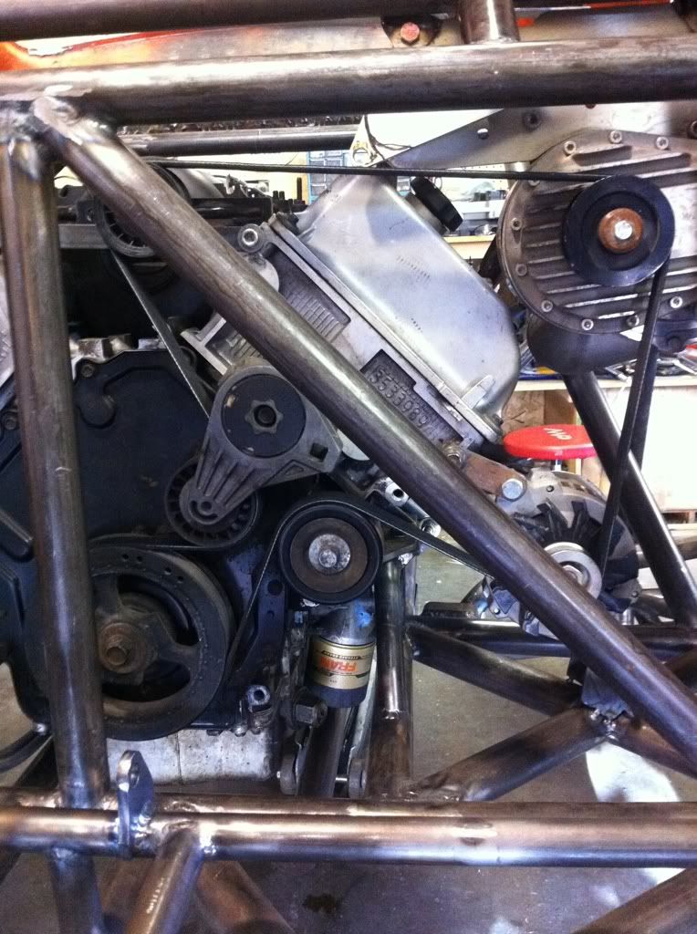

pic updates...
built a dimple die battery box for my yellow top optima.. the front end will have a access door for battery
pedals mounted.. cable shift shifter mounted.. made some patterns to be cut in aluminum for guages and cover wires panels.. and floor..
clutch slave and supercharger mounted.. working on belt drive and skid plate tabs..

I got some aluminum work done... floors , middle section, and fire walls. finished bumpers w/ hitches .. new fuel cell and fuel cell mount!!
I also finished serpentine belt with supercharge and alt mounts done..
ill be working on door mounts and body mounts this week.. then limit straps and bump stops.. brake hard lines.. throttle cable mounts.. then strip it back down for 3 weld session...
