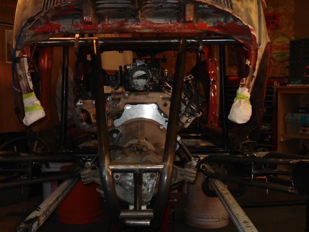

lol...heres my plans, but who knows ill have to see how everything comes together...the main goal is get all the majors stuff in and see where the rest has room!
tires ?? 33x10.5 front 32 x9.5 ?? or maybe 32" and 31"
i am trying to keep the body kinda stock looking as far as keeping motor hood skirt and fenders..i have some 3 inch wider fiberglass im going to form to fit.. my buddy had a great idea to cut some more vents in the hood install the radiator and fans there behind the hood or flat over trans..then I am thinking about making a tire mount over the engine at an angle on roll cage..id have to stick the spare tire threw the back window..originally i wanted exuast coming out side windows...but looks like that will be a stretch..probably run them out the back in skirt..
This is my first buggy build.. im a custom painter-bodyman by trade and i have lots of plans there ..it will be pretty trick..blasting the whole thing.. lots of fiberglass work.. pop doors w/shaved handles.. ect.. hopefully someday.. Wink
As far as building the motor..maybe down the road..but honestly I think my trans will not handle the 300hp i have.. once i get to upgrade that then i might.. I do want to keep the motor really reliable.. i did hear will a simple valve job on the northstar and i can pick up 100 more hp.. Twisted Evil ill be working on rear removable cage this weekend..more pics commin..

I'm curious as to why you went with the 914 trans. Looks like a cool build......
northstarbeetle
Joined: February 06, 2009
Posts: 134
Location: golden co
northstarbeetle is offline
PostPosted: Tue Mar 10, 2009 7:21 pm    Post subject: Reply with quote
ok ..thanks turnaround .. i am aware the 914 trans wont handle 300hp.. Porsche does claim it handles 200 to 250hp but it has a weak first gear and does not handle shock loading....
I know a guy who runs a swing axle to his northstar..he just cant put his foot in it or pop clutch...had it for years..
I went with 914 because it is already set up to drive a mid engine.. I dont have to do anything to it, they are super cheap $150 and stronger than any stock vw trans....
if I went 091 i would have to run it upside down w/ a oil pump, because u cannot flip the ring gear on the 091.. its not very strong and puts your cvs like 5 inches higher...
Im going to be putting a 915 with a flipped ring gear down the road around $2500 built, its a much stronger trans than 914..
a built 930 or mendeola is the way to go... Hmm maybe when i can afford to drop $5000 on a trans...
Want to sponcer me?????
Untill then I have to go the cheapest route (because im poor) and focus on getting my build done first, then upgrading later.. the rear removable cage is large to accept the bigger trans, Ill just have to change the trans mounts and maybe axles!
Here is a few pics.. hopefully ill finish rear cage sometime this week then on to front end.....
