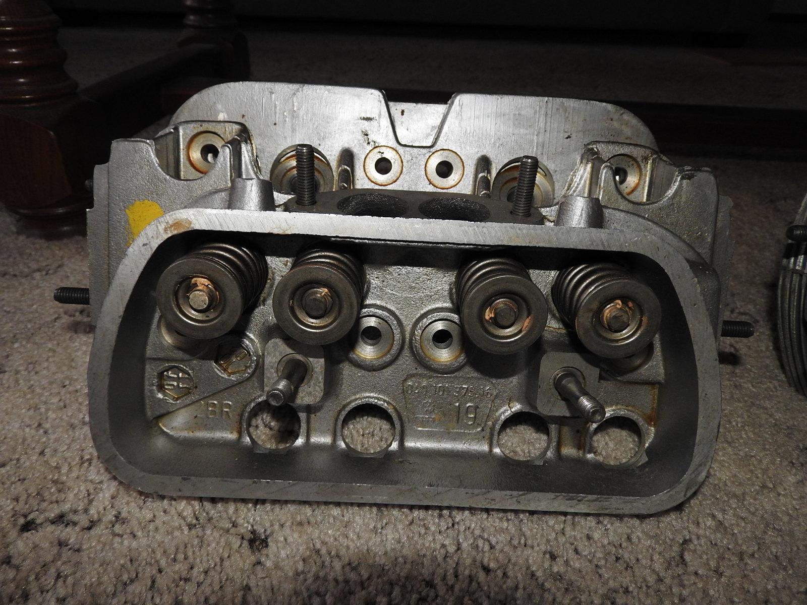

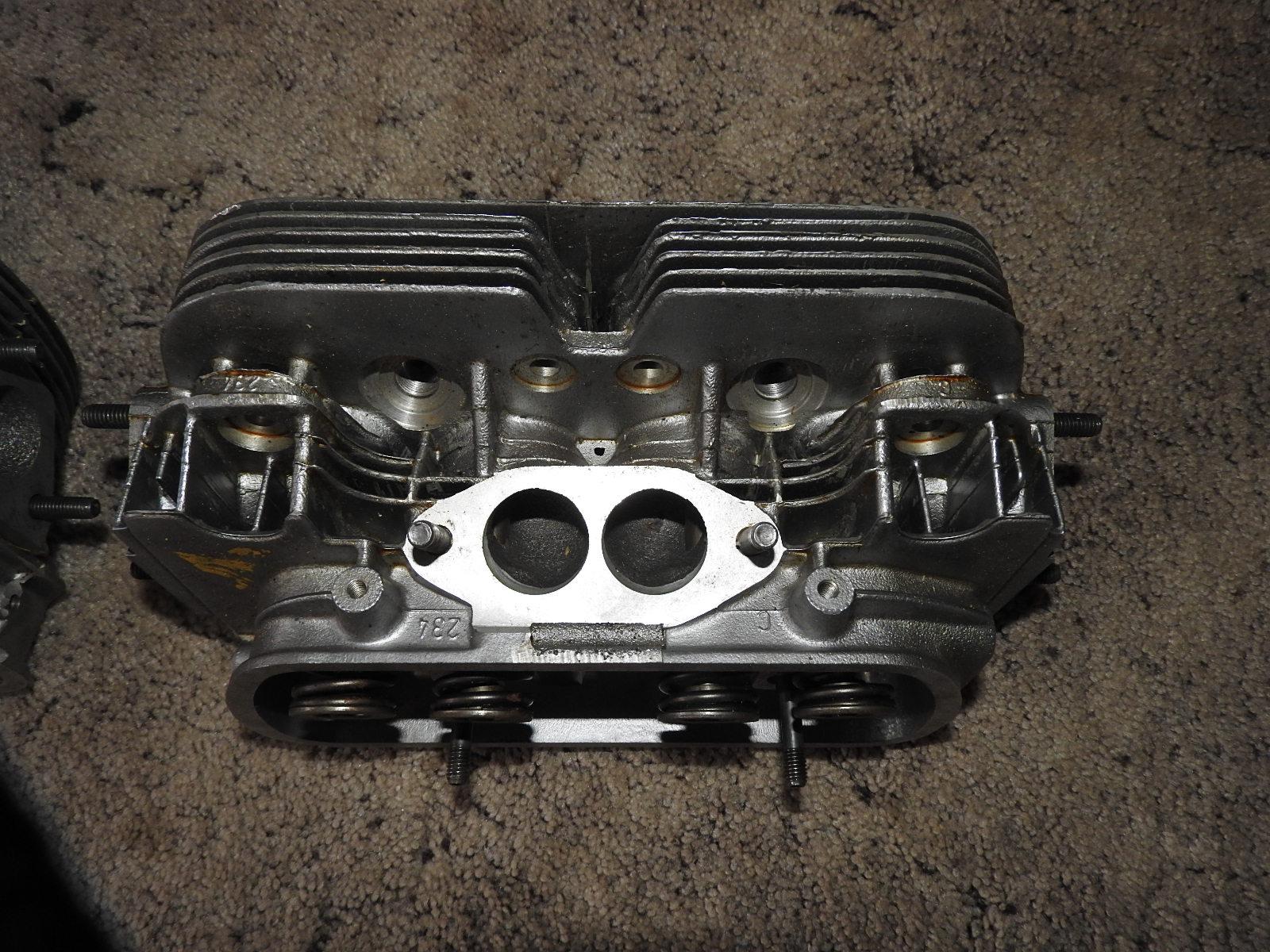

A friend of mine got some heads from a machine shop and they dont look like a regular heads.
First of all they only have 6 main fins compared to 8 on a standard head, and NO they are not cut off as they still have the "ears" on the bottom fin.
Second they only have 35cc chambers and a VERY shallow depth from the bottom fin to the sealing surface.
Third they have a wierd horizantal threaded 8mm hole on the #1 or #4 piston on the SIDE of the head right above the hole for the valve cover bail
Fourth a strange part number with additional numbers and NO letter designation. 040 101 375 16
They have stock size valves 35x32 but have long reach plug threads. He was told they are regular heads but I say no way. Someone told him they are early replacement FI heads but do not have the larger valve stem. They have a BR stamping in the spring area so they look like Brazil heads and also have REALLY small washer bosses so that regular 8mm head stud washers barely fit. There is NO WAY that these heads can use a 10mm head stud!! Intake ports look like later 041 style with no valve stem boss but have early small exhaust ports. They also have 041 full bottom fin with no full middle fin when looking down from the intake port side.
Are these industrial heads? Early factory racing heads for super high compression? Aircraft??
He is building a 74x90 engine and when setting the deck height and comression ratio the amount of shims needed is huge to compensate for the super small chamber size. He is unable to use copper head gaskets due to the almost non exsistant cylinder seating area. If he uses a .060 copper head gasket the cylinder will not locate in the head correctly even after torque. WTF???

Those are alcohol heads. In stock form, this 1600 had a CR of 10.5:1.
Don't even think about using them on a gas engine. Less fins means they will overheat. Super high compression means they will ping badly.

I have the exact same set of heads but mine have the 8 cooling fins, 32 X 35.5 vlaves and the boss is there for the horizontal threaded hole, but it is not threaded.
My chamber volumn is no where near that small, (have not cc'ed them yet, but look real cloase to my stock 041 head volumn).
I am going to use them on my 78 X 88 build (1898).

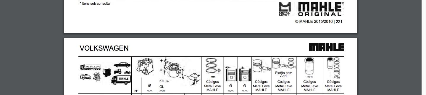

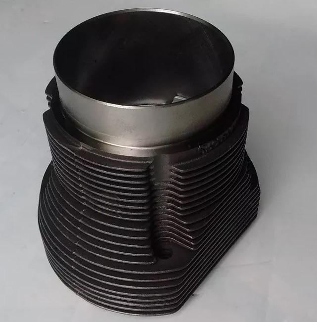

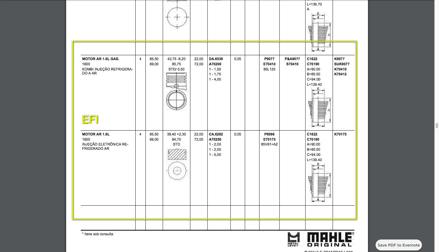

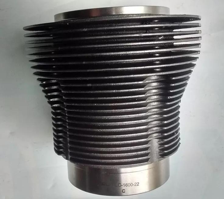

Those are heads for the engine nicknamed "Tork", introduced after 1984 in Brazil. There were ethanol, gasoline, fuel injected and front mounted versions.
They were designed to be used with matching cylinders/pistons, the cylinders have more fins to compensate the only 6 fins on the heads.
The table below show the dimensions, I don't know if it will fit the regular P/Cs
(The "C" measure is 94mm vs 93.81mm on regular cylinders. The "L" measure is 138.60 or 139.40mm vs 136.70mm on regular.)
