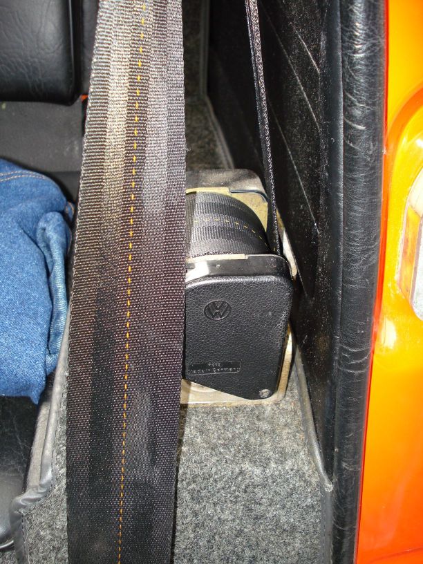

wolfgang klinkert
Joined: March 04, 2009
Posts: 209
Location: NRW - Germany
wolfgang klinkert is offline
PostPosted: Wed Jul 22, 2009 6:15 am    Post subject: Reply with quote
I have retractable belts im my '73 Karmann Ghia, which were directly ordered from factory by the first owner of my Ghia, when he bought the car. Cool
Here you can see the position of the ORIGINAL "mounting point" beside of the rear bench:
Please find another photo here:
Arrow http://images3.bilder-speicher.de/show.php?type=image_800&id=09022618790151
With cordial "Karmann Ghia"-greetings from Germany
(O = i = O) ~~~ Wolfgang Klinkert ~~~ (O = i = O)
»»» [Member of "Karmann Ghia IG Lippe in NRW"] «««

I would bet that the '71 and earlier mounting procedure is different than the '72 and later.
My '72 has the mount exactly like wolfgang's. Great pics.
