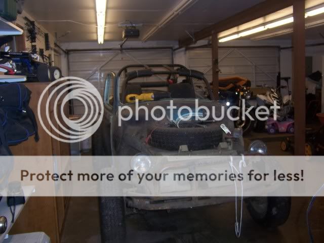

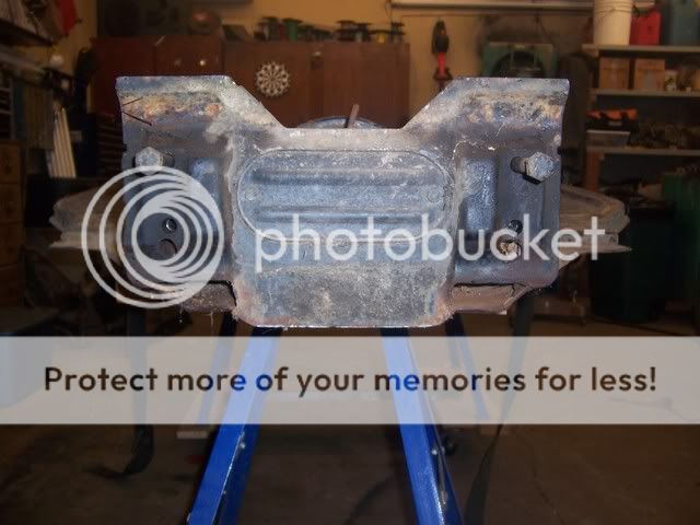

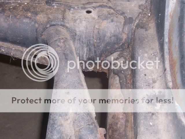

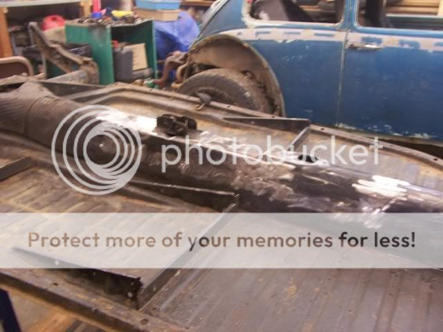

here is the first couple pics i've taken of my baja project. i in the first stages of the build. I used an older pan so i have the option of link pin down the road if i want. probably use a ball joint for now though. I already welded in irs gussets, relocated the heater cable and ebrake cable tubes in the frame horns, now i'm in the process of putting late model tunnel part the holds the ebrake and heater lever, also the shifter location is further back which i like better than the early model so i'm using that also. i would of used the irs pan i had, but the tunnel was severly rusted in some major spots so i chose to go this route. so far so good.
watch out for my thumb!
I guess this body don't fit so well, lol
just though i would share my stuff. i'll keep posting more pics as it continues. hope you all like it.

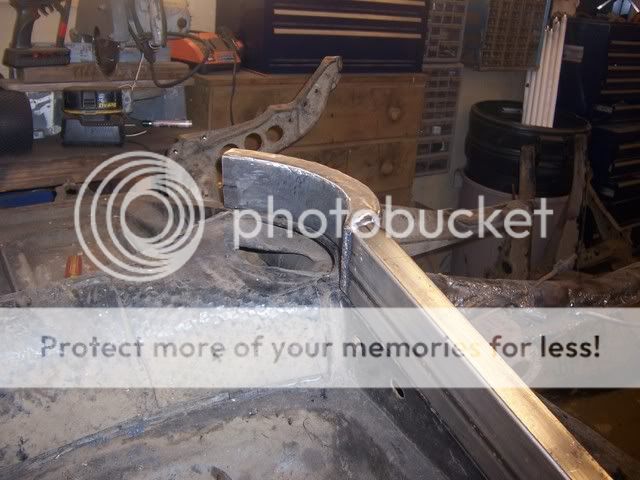

If you cut off the two lower tabs on the link pin frame head and drill two new holes for the bolts a ball joint will fit, the lower tube is just a little bit lower. and use thru bolts with nuts on the backside. done it before. works great. i'll show some pics later.

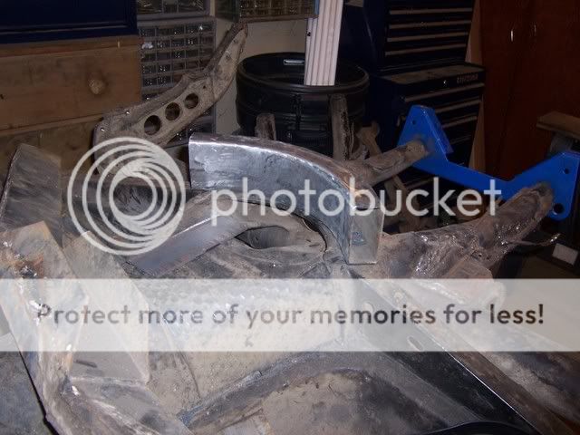

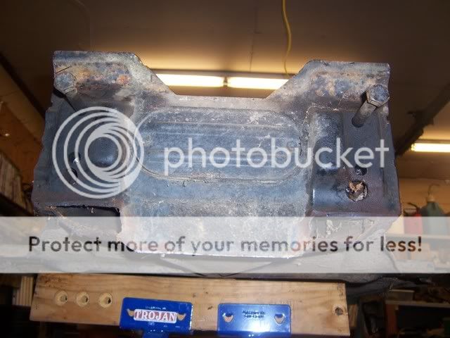

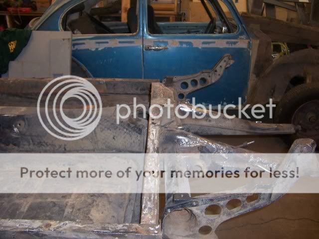

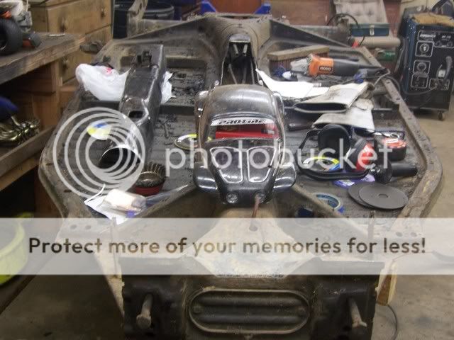

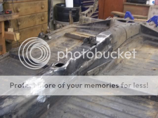

finished my tunnel today. pics are kinda blurry. also put in a couple pics of what i was talking about with the ball joint on a link pin pan. still need to clean it up and fill in the holes.

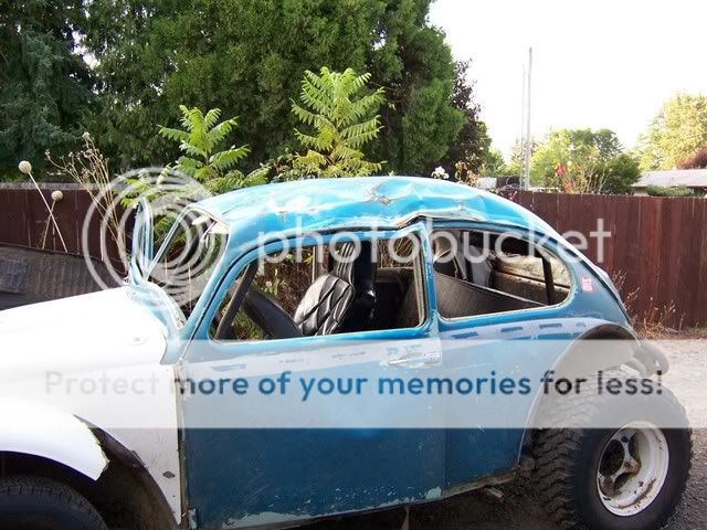

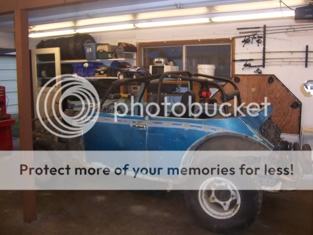

this is my old baja. seen better days.

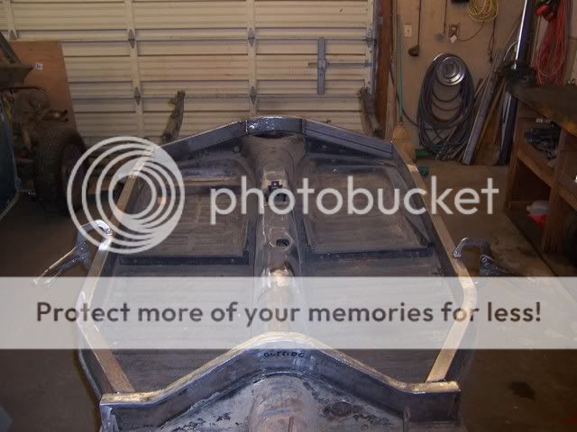

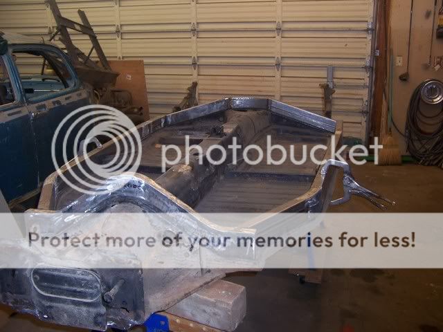

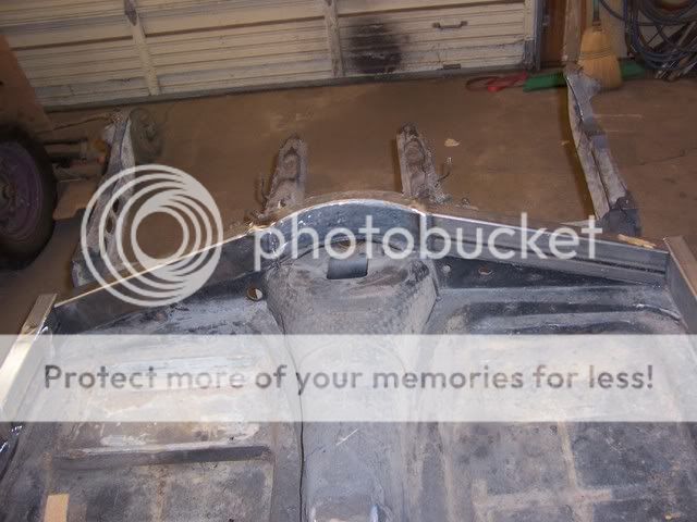

O.K. so here are some pics. the first is where i welded up the holes on my frame head. Now i can bolt up either a ball joint or link pin front end.

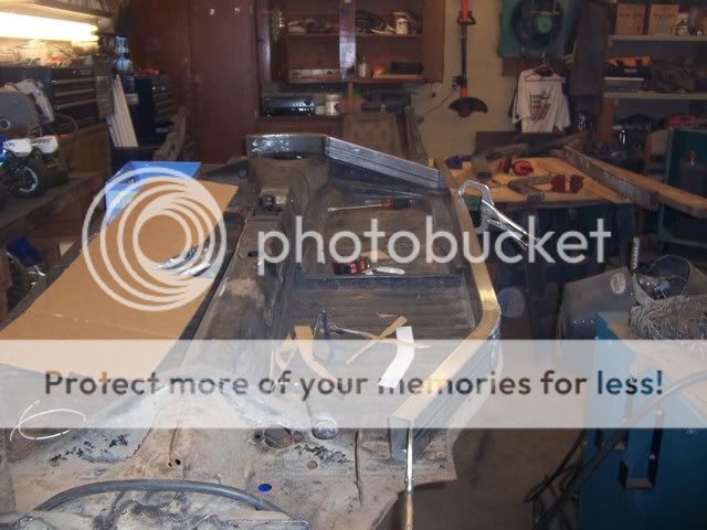

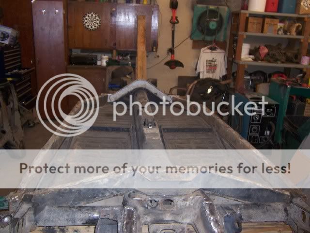

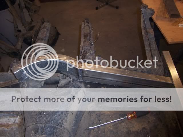

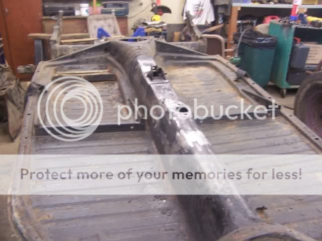

and here is some pictures of my lift that i'm fabbing up. it's only about half way done so far. I'm trying to keep everything the same shape as the pan the best i can. this is the piece that goes over the hockystick. i didn't like the cheesy one that came with the lift.
here is a few different shots(angles) of what i've gotten done so far.
what do you think? I'm pretty happy since i don't have a whole lot of welding/fabbing exp. i'm learning a lot though.

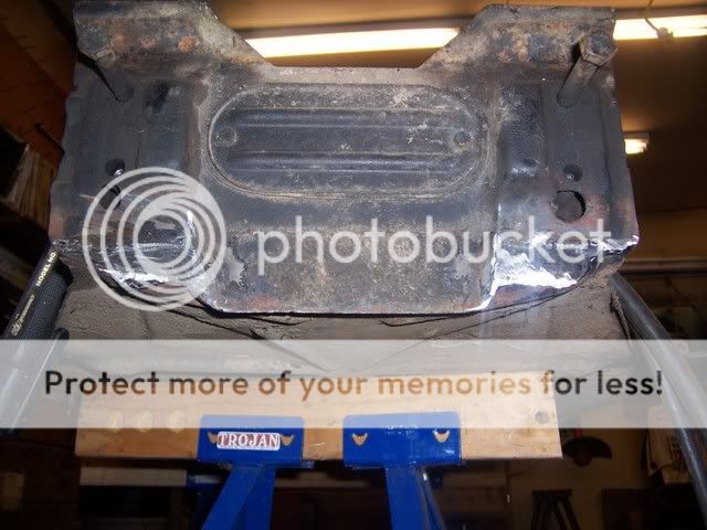

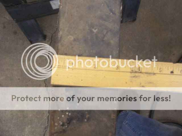

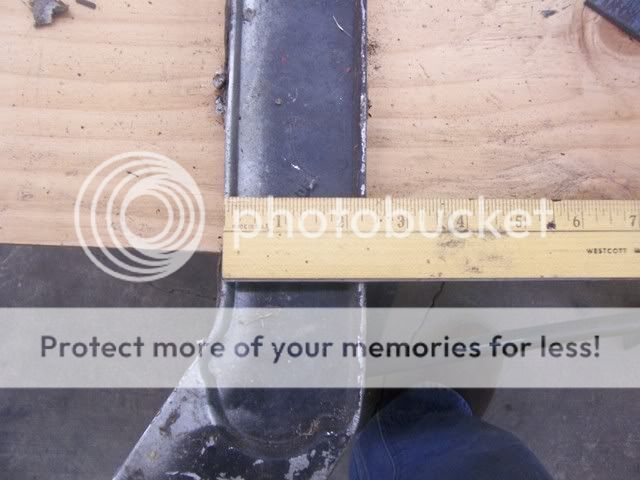

I do have some questions. the piece that fits over the front tunnel that came with my lift is different dimensions than the rest of the lift. it is 5/8 inch shorter than the rest of the lift. what gives? could i have gotten screwed when i bought the lift? i want to fab that piece also but unsure on what to do? should i keep it 3 inches like the rest of the lift? or make it 2-3/8 like what it is now. Here a couple pics.
this is the original piece that goes above front tunnel 2-3/8"
this is the original body lift 3"
this is the two pieces stacked, you can see the difference. it's huge.

PostPosted: Mon Nov 16, 2009 8:17 pm    Post subject: Reply with quote
Your measuring it wrong. You have to measure vertically as it would sit on the pan. Remember that section you have your ruler on is at an angle. So your ruler will not be 90 degrees to it when you measure. Dont know what the angle is but guessing 30 ish degrees. ?get the picture?
If you measure the section at the top of the curve (center), it should measure out ok.

PostPosted: Mon Nov 16, 2009 8:34 pm    Post subject: Reply with quote
good call. that makes sense. thanks. I'll have to check the rear piece. i may have to redue it.

so i got my lift pretty much done. just got a couple small welds, clean it all up, drill holes, then tack it all together(make it one piece) and then test fit. cross your fingers. here is some more pics.
this is the old lift... me no likey
see how the piece above the hockey stick is all cheap.
and along the sides of the pan, has crappy welds and it's not shaped like the pan.
here is the one i built
took some time but it was worth it.
if you look closely you can see that i followed the pan shapes the best i could. I should be able to weld it all together when i'm done, and then weld a cage or whatever i need to to it. Hopefully i'll get some time friday to work on it. if not it will sit till monday. Crying or Very sad
when i go to put it all together i was wondering if i just got a lot of urethane or silicon and gooped that all over the pan, lift, and body if that would seal good, of if i should do two belly pan gaskets and silcone or urathane or something? any opinions?

well i got my lift all done. holes drilled and all welded together. on the test fit the front piece over the tunnel had a gap, so i'll have to fix that, otherwise fit pretty good for a newbie fabber. replaced the rear right pan section and patched up some small holes today. hoping to be putting the body on in a week or two. got some work to do to the body before i can match them up. sucks having very little $$. I'm just going to have to primer and paint the pan and whatever else with rattle can. Oh well.

so i bolted up the lift against the pan and only have two spots that have a questionable gap. easy fix though. still got to bolt the body on as a first real try to see my gaps there. hopefully not too bad. sucks being on a budget though, not really a budget as to electricity and house or baja??? Hmmm. baja! well maybe i need electricity and a house to work on it. anywho... I do have a question for all you gurus out there.

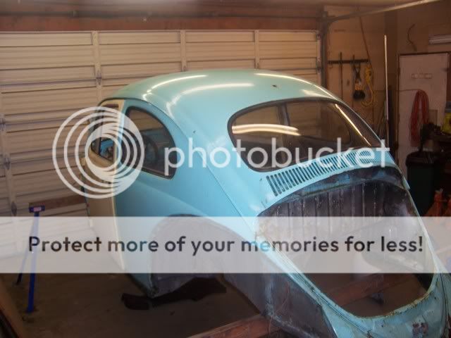

this is the body i'm going to use. It's a 64, has 66(i think) doors on it but i got a coupke 64 doors i'm going to put on it.
front and rear firewalls look pretty good.

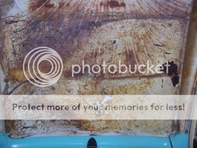

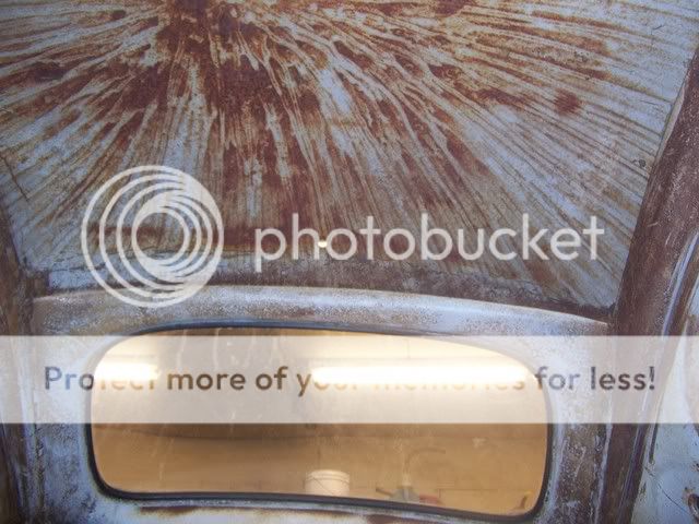

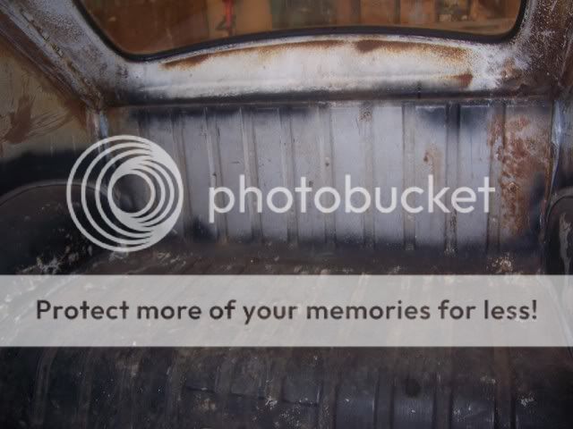

it does has a good amount of surface rust though, break out the sanding disk... this is the inside roof front to back

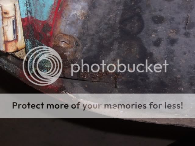

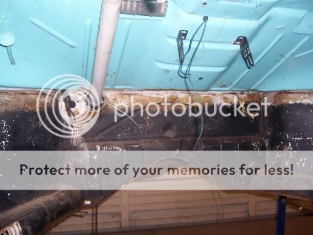

here are a couple more trouble spots. I'll do what i can.

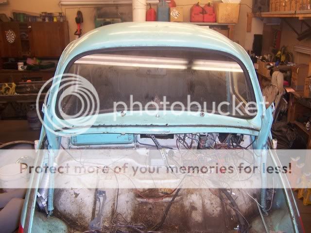

and this is before and after starting to cut up/part out my old baja. After cutting the roof off, kinda makes me want to save the body and pan and eventually make an offroad/dune baja. obviously it would be a long time coming, but then i could have my dd/ weekend warrior and a full on dune runner.
