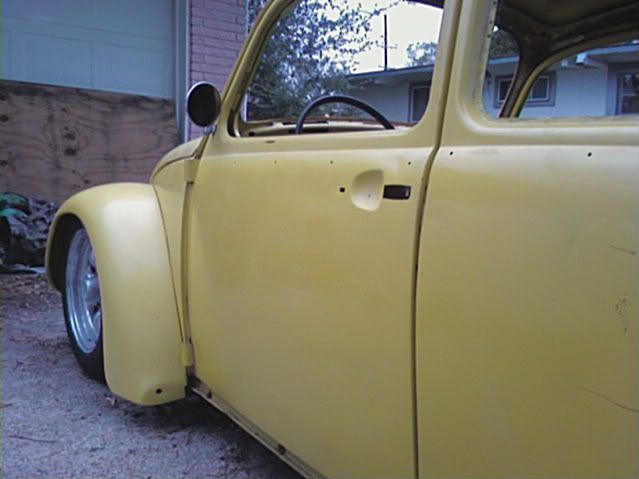

I got some donor windows from a super bug and thought I might use the doors but the trim line is higher then the 69 Bug I have. It looks like your doors are from a standard Bug. Confused
Bob
millerje78
Samba Amishman
Joined: October 16, 2005
Posts: 2526
Location: Holmes County, Ohio
millerje78 is offline
PostPosted: Wed Jan 06, 2010 8:09 am    Post subject: Reply with quote
Bob
well thats strange then. I wonder if there were changes in trim location sometime between 68 and 73?? maybe my drivers door is from a super beetle?

PostPosted: Wed Jan 06, 2010 3:26 pm    Post subject: Reply with quote
The newer doors have a reinforcing piece inside behind the window also, side crash protection. That may be why they moved the trim line.
Get the holes welded shut and put new holes in for the trim. Smile Good luck with the project.
