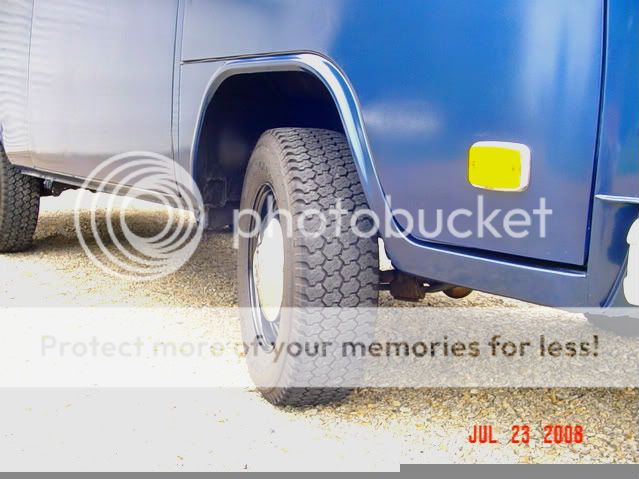

I've been needing to replace my passenger tires (yes I read all the posts and stickys about the correct tires for my bus) but just didn't have the money to order a set of Hankooks or equal. We're geting ready to put some miles on this bus, so I had to do something to be able to drive with confidence and know my family is safe. After calling every tire shop in town, checking prices on new and some used, here's the deal . . .
The manager at one of our larger tire shops asked what they were for. When I explained, he said come on back - I might have something. He showed me a room full of "take-offs" (tires replaced before their time) and led me to several stacks of Goodyear Wrangler AT's. These were all take-offs from the local postal service vehicles (those new weird looking things) that were replaced by calendar date, not by need.
Here's the specs:
- Goodyear Wrangler AT , LT195/75R14, 6-ply, Load Range-C, rated up to 50 PSI
I was able to easily pick a full matching set with about 80% tread, beautiful condition, and there are still about 20+ tires left in his stack.
Now, here's the deal: $17.00 a piece Shocked
My total bill incl. mounting, computer bal., new stems, disposal, tax, etc. was $68.00 Dancing
Needless to say, I rode home a happy man. Can't beat the deal, and this thing rides like a new vehicle- no more wallowing around. These tires are smooth and quiet, but have some nice tread for offroad when we're following those 4-wheeler trails!
Just thought I'd share the love, and if anyone in south-central Virginia needs tires, I'll point you to the place. Heck, it may be worth asking around different parts of the country - I assume the Fed.Govt. does it pretty much the same everywhere.
- Klauss

OH! What is the DOT date code on the tires? The last segment in the line that begins DOT?

That's what I was wondering, I need the date. If they took them off due to going past the calender date, they are probably over the 6 year expiration and unsafe. If not, good deal!

Since my tires are the wrong size AND over ten years old, AND I have scarce money, it might still be a good deal...

I'll check the date code and let you know, but to look at all the more tread wear these tires have and the condition of the rubber, they can't be very old . . .

That is the problem, they look good and have good tread but the rubber is old and prone to failure. Watch this video for good info:
http://abcnews.go.com/Video/playerIndex?id=4826897
I checked mine, 10 years old Shocked Look at the code on the side to determine the age (it might be on the inside). If they are within reason age wise, put me down for a set!

Too bad the weight load is only 1435 pounds. Crying or Very sad

Isn't that per Tire? if your bus is grossing over 5800lbs shit will happen.

Which exceeds the rear axle rating so it is fine. The owners manual for a 76 calls for a 185 R 14 C 6ply tire or a 185 R 14 reinforced, he should have no problems running a set of LT195/75R14 6ply tires.

The number to meet or beat is 1540 pounds.

The rear axle rating for a 1976 Kombi is 2866 pounds, half of that is 1433. Last time I checked 1435 was greater than 1433. Station wagons and Campmobiles are rated less than a Kombi.
