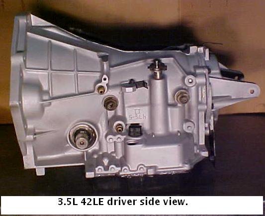

I have also been thinking about this conversion with the 42LE automatic transmission instead and not in the mid-ship configuration. The 42LE transmission has a chain drive transfer case already built in the rear. I have been thinking of cutting some gears to replace the chain drive that would allow 4 forward and 1 reverse gear when mounted in the standard Vanagon configuration. This would also allow the automatic to be used with the Syncro.
Just my 2¢

smokin dodge is really a cool avvy. This will fit under the deck with 9" g.c. Originally, the ceo of the then newly acquired
american motors headed up the LHS project and personally pushed the fwd longitudinal configuration through. Iacocca was
planning his retirement and they were going to out do him with this totally cad-cam generated design [avoided mockup for the
first time in modern automotive history].
anyway, this ceo wanted it to be designed available to awd if sales supported it. the outback was building inside the legacy
and the quattro dominated the 80s with awd in racing.
I'm sure they had drawings for driving the rear wheels. so a longer output shaft and tailcone with a bearing and seal would be a
good start. the syncro would enjoy the traction control as well. this is egghead stuff. software adapting the awd sensors and such.
the subframe horseshoe or forward structure will be fitted to interface with the vanagon structure. There are some tricks I learned
on the wing dock back at douglas aircraft. I know how to stem frame stress. how to manage it. when the center cross beam is
severed, the van will want to
bend into itsself. the edges of the floor around the inboard pins would fatigue downward from the wheels upforce.
so a strong bridge must be inlaid, probably with reciever sleeves WITHIN the cross member, spot welded thru multiple holes,
spreading the load over a broad area of thin steel. laminating or lapping is then appropriate for the surface to weld the
subframe to, all flushed in. the factory mounts will be used [the latest revised versions], bell housing joined and the rear cross
member for the trans. all quiet design.
I may have to shift the e/t to the left 1" to compensate the diff offset. [one halfshaft is 6" longer than the other] or so. not enough
to throw her sideways in a bind.

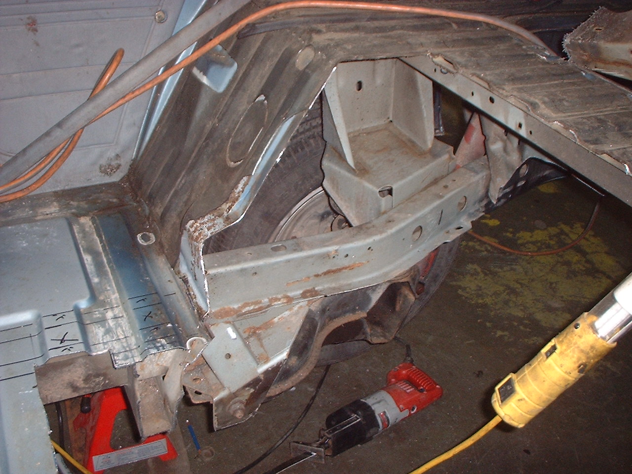

I actually started CUTTING the floor today, after hauling 4000.00 worth of STUFF to goodwill--sayonara!!!! I can clear my mind to
attend to the hole that is growing in the middle of my 89gl. the longitudinal subfloor beams arent placed as precisely as I would
have expected. they vary from center as much as 1/4"
It's amazing, all the prep work it takes to get to this point. everything runs down the middle through this area and needs
pulling back. the harnass is unlaced to the fuel tank and is hanging through the closed slider window on the drivers side.--turtling on...

abrasive wheels are quite effective. theres 23" in between those trailing arm pins.
wednesday the V6 comes out for prep and mockup / dimensioning.

PostPosted: Wed Jun 30, 2010 7:38 pm    Post subject: Reply with quote
left side
right side
full face
It never occurred to me to paste an image- I thought I was cluttering the board up if I did.
