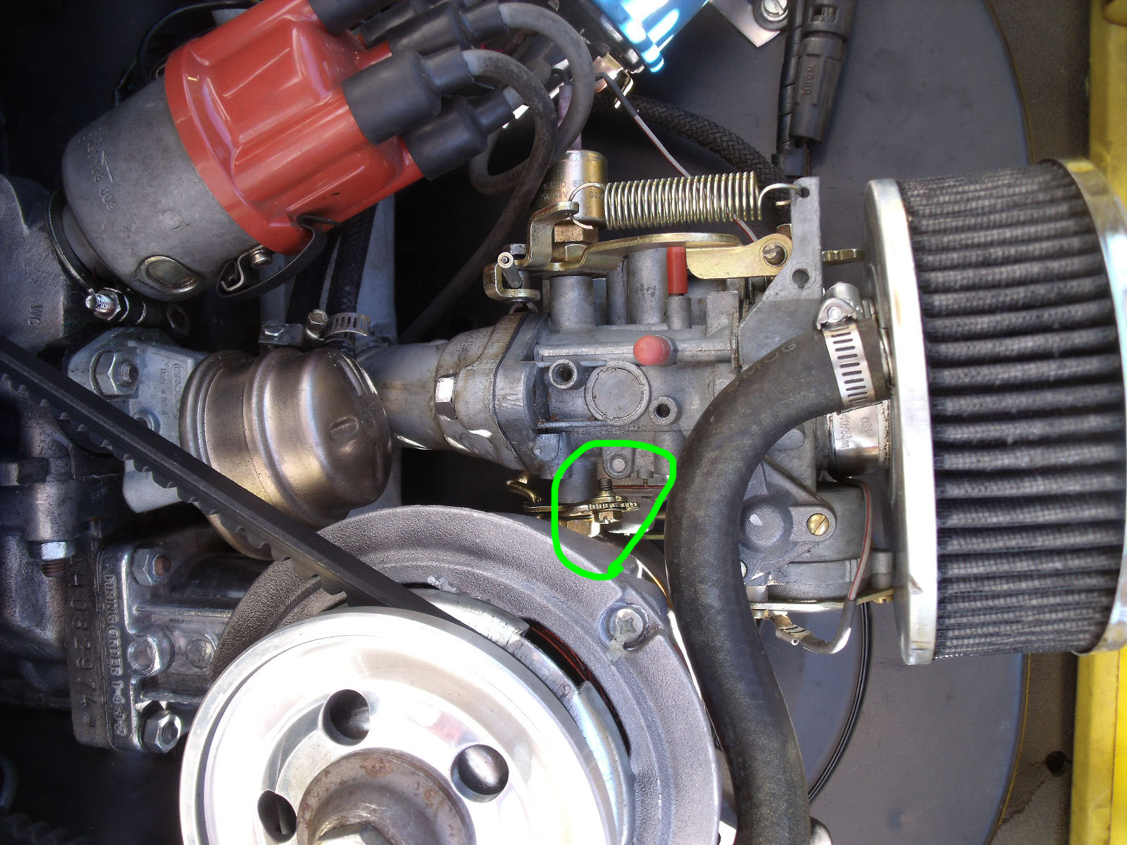

Alright, so i took an old 34 that i have that has been rebuilt and had it installed yesterday... the cars seems to be running a little better, however the accelerator pump (i think it's called that...) on the right side of the carb hits the alternator... so when i was driving home from the shop last night, i accelerated to get up to speed on the freeway and my throttle got stuck wide open because it was snagged on the alternator... is there an attachment or adaptor i can put on so the it raises my carb like 1-2 cm? I'll post pictures in a sec..
so random other facts about the car, it on a 009 distributor with electronic points/ignition, it's running an alternator, rebuilt engine as of about 7,500 miles ago... and that's all I can think of tat might be relevant right now...

PostPosted: Thu Jul 01, 2010 3:51 pm    Post subject: the picture explanation Reply with quote
since the quality of the pictures is so limited, it's difficult to see what happened. i tried to point out where the carb is scraping and snagging on the alternator in green :]
i apologize for them being sideways.

You either need to go back to the H 30/31 that clears the alternator, or grind the alternator housing or get the correct "alternator" style linkage to fit the 34 pict 3 that won't rub.

What is the latest? Have you fixed the issue with the Alt?
It would seem a bigger carb is better. These later dual port cars all suffer from a "flat spot" on accel that's hard to tune out. An 009 my make it worse too. You can enlarge the jets to overcome some of it but the mileage will suffer. One thing you can't easily change its the gear ratios in the trans. They have a higher ratio which means the cars bog a little trying to overcome the load off idle. It's like taking off on a bike that's in high gear, hard to pedal at first but you go a lot faster when you do get going. I learned when using a '73 as a DD just to shift down when it bogged and use a lower gear.
The alternator has plenty of meat on it, you can grind the housing until the arm clears.
When you get settled and have some extra money put some Kadrons on it and it will come alive!
