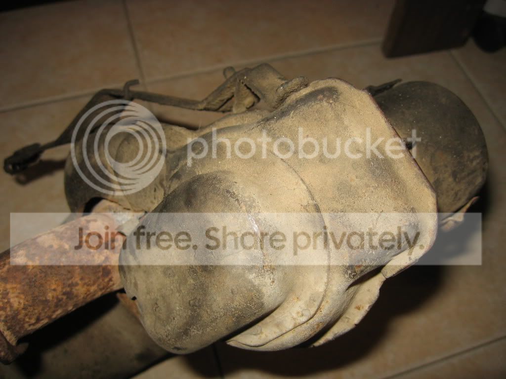

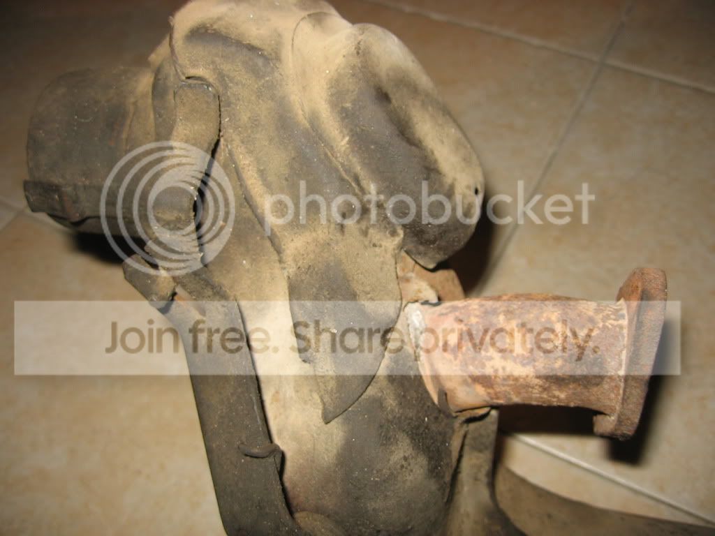

There is a vent on top of the exchanger, it is sort of round in shape. When the heat to the cabin is closed off, the hot air escapes through the vent.
Here is my exchanger. I don't see any vent.
Paul Windisch
Joined: September 02, 2009
Posts: 2257
Location: Fraser, Michigan
Paul Windisch is offline
PostPosted: Wed Jan 04, 2012 9:41 am    Post subject: Reply with quote
Here, I cicled it and drew an arrow where the vent exhausts:

I looked closely and finally got it. The dome actually has an opening at the bottom - the bottom is not welded to the HE like the rest of it. And it's hard to see but I guess when the flap is opened it actually lays flat on the inside if the dome shutting it off.
yep, now you got it...
