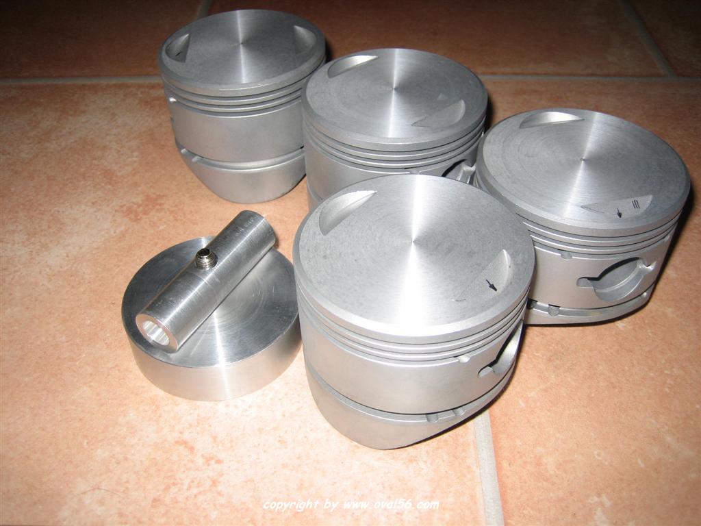

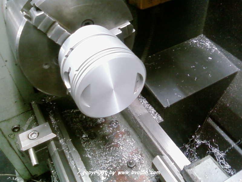

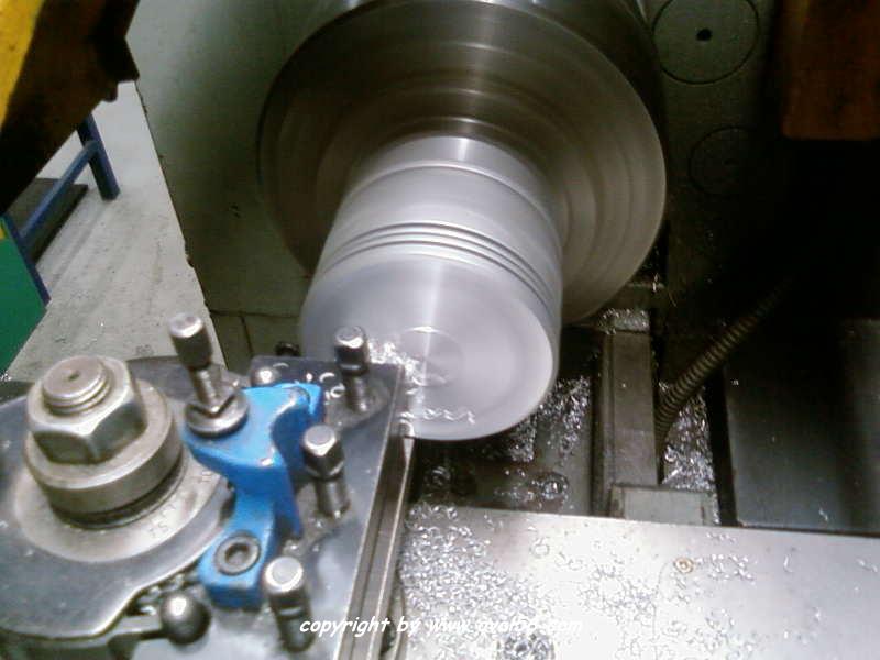

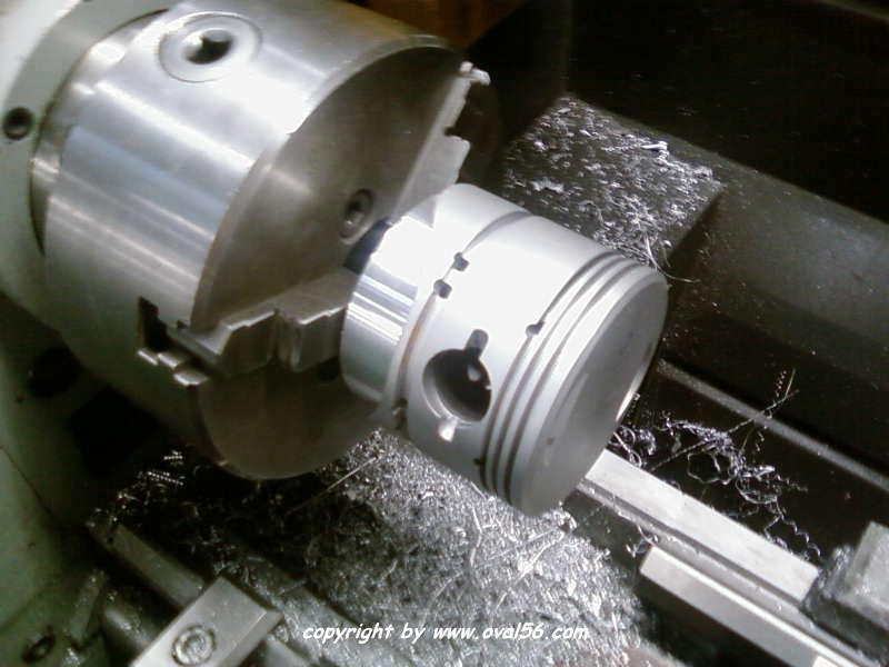

flattop porsche pistons, no problem, to machine em down wit a lathe..
did it on mine 0,6mm had no picture availible at the moment, webserver crashed down... tomorow i think i'm able to find that picture and post it up

Oval 56
Wow that is a very nice job. How long have you been running those pistons? What kind of HP?
I will do the same to mine.

10000km ~ 6300mls 88ps ~88hp 1582ccm

88 HP I bet that is a blast to drive. Are those 82.5s Have you had any sealing issues cylinder to case?
Thanks again
real fun to drive Smile i enjoy every minute...
yes 82.5's
i machined the botom of the zylinders down to 88mm and modified the case, no problem, works fine, the only oilleak i have is trough the oilfillertube Wink
