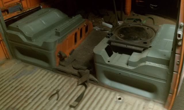

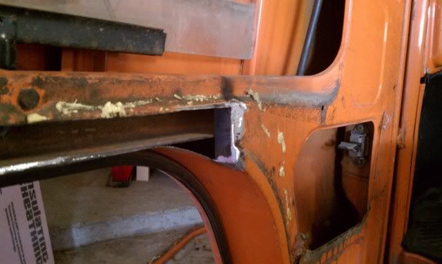

Well I have some pics of the front tub work. Just welded in some 14 gauge steel, and yes I know my welds suck! Soon I will have a plasma cutter to clean up some of the excess metal on the back of the tub, I chose to leave it until then.
On a side note I recieved my air tank so I'm setting up the air lines etc. for the rear bags. She will be alive soon!
Top section cut out for the tub work
Two inch plates welded to the front and rear
The almost finished product, I still need to grind some more and clean up some stuff.
Pic of the seat bracket, shows where you need to drill to remove the spot welds
Box I made for the other seat bracket, ugly welds you can see here Crying or Very sad
A pic of the door cut out I had to make to fit over the tub. It has on piece welded to rebuild the door metal. Soon enough I will finish welding the rest but need a plasma cutter first the get the cuts nice.

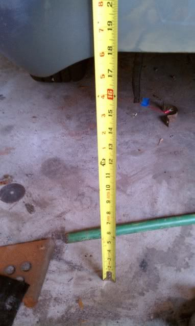

I was going to try and wait till the engine is back in and all the stuff is cleaned up for a vid but I might have to do one premature. I did take a couple of pics with the rear aired down and then aired up! It is of course going to be much lower when the weight of the engine is back, wish the new one would hurry up and show up!
No air running just on the rear torsion bars and shocks without the engine weight at 14"
Bags aired up with 100 PSI at 18". I need a better camera and a budy to come by and take some wider shots while I air it up and down to get a better ided. 4" of difference is plenty to save my engine from speed bumps and my driveway! Tired of sparks and scraping!

Still no video of the bags, should get one soon. Did finish the tubs on the driver and pasenger side though. I have them cleaned up and finished, now for the pics.
Pasenger side cut out
The rear plate I made with my new plasma cutter! Love new tools Shocked
Pic with everything done and the seat bracket welded back in.

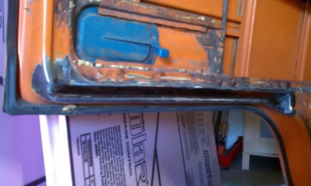

PostPosted: Tue Apr 05, 2011 4:41 pm    Post subject: Reply with quote
Finished boxing in the driver side door cut out. Its fits nicely around the tub and after a little cleaning up will be ready for paint.

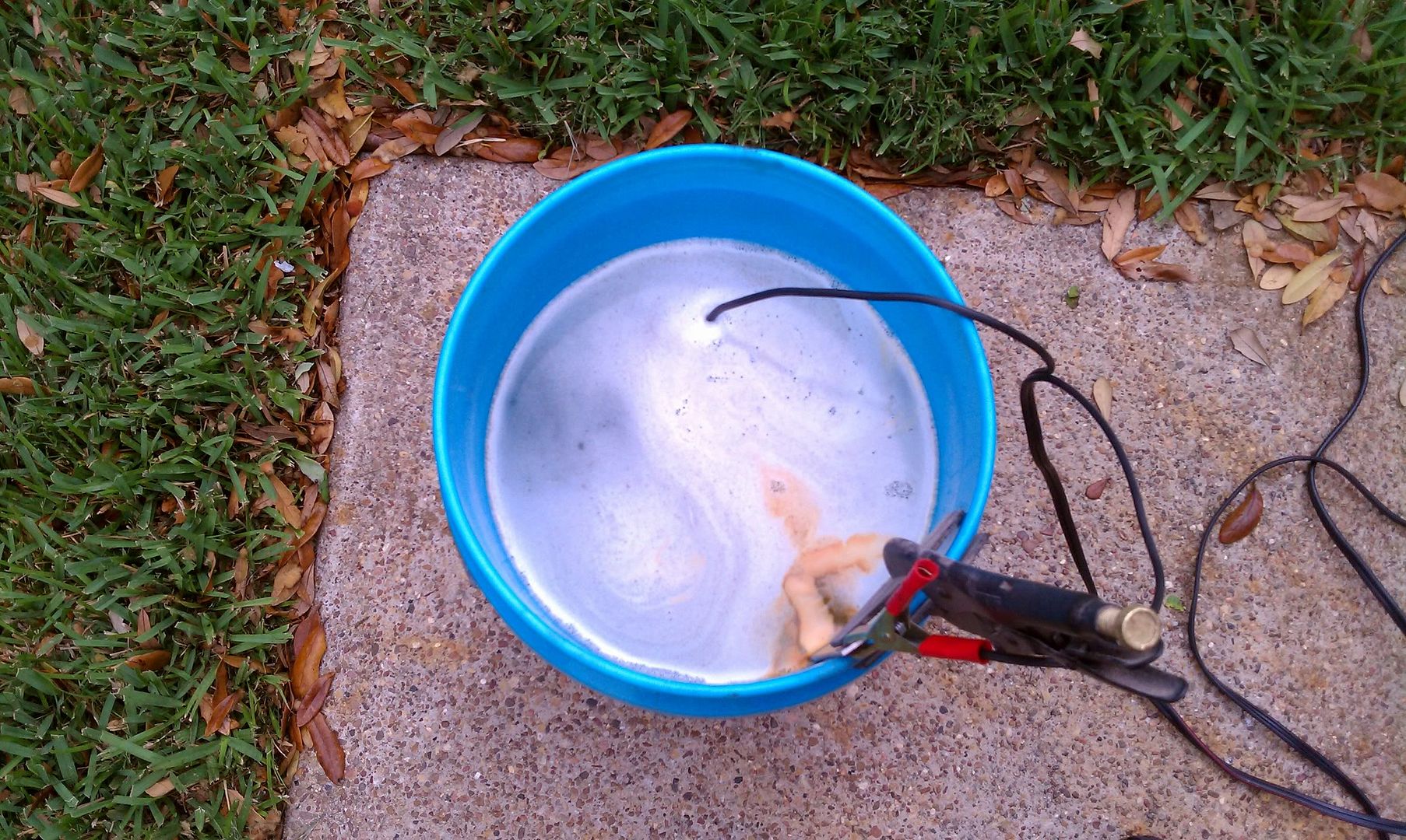

PostPosted: Thu Apr 14, 2011 5:17 am    Post subject: Reply with quote
Made an electrolisis set up to clean up rusted engine tins etc.
Finally got my new engine!!!
I will start the engine build today. Btw, my cooler fan has one missing blade, do I need to replace it?

surfer459 wrote:
Looks like your cooking shrimp! Shocked Razz
