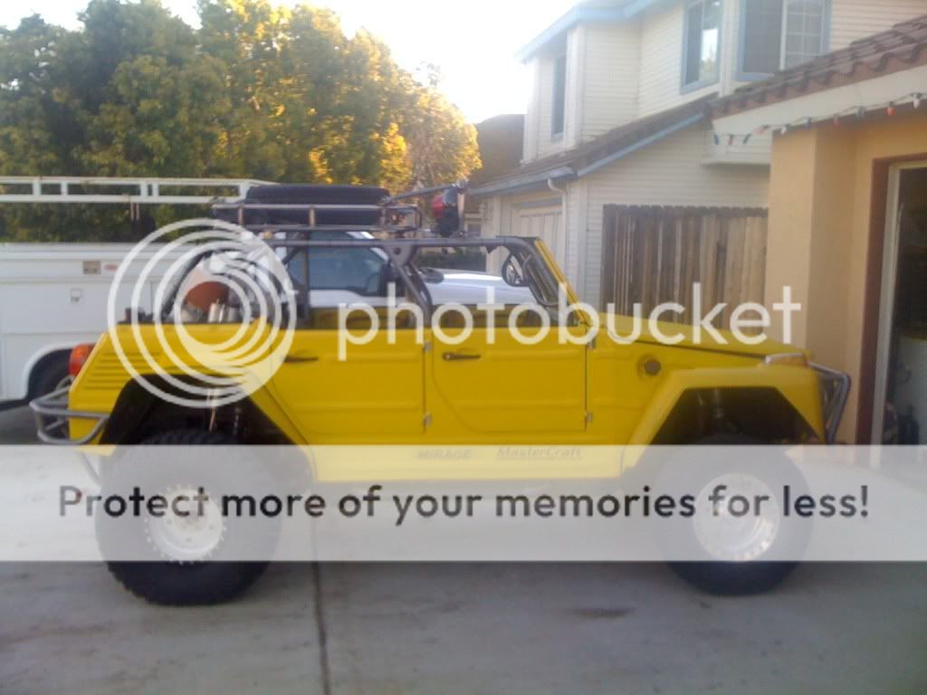

Hopefully the noise goes away nicely (although not usually the case). Here is a picture of my Thing. I'm not sure what day we will be heading down to OW.

Thats very nice. I like the wrap around rear bumper. Smart. Does yours have a top. I see the rack on top and it is a great idea for spare. I would like to have a top for sun and dirt.

Thanks for the compliments and yes, there is an aluminum roof.
