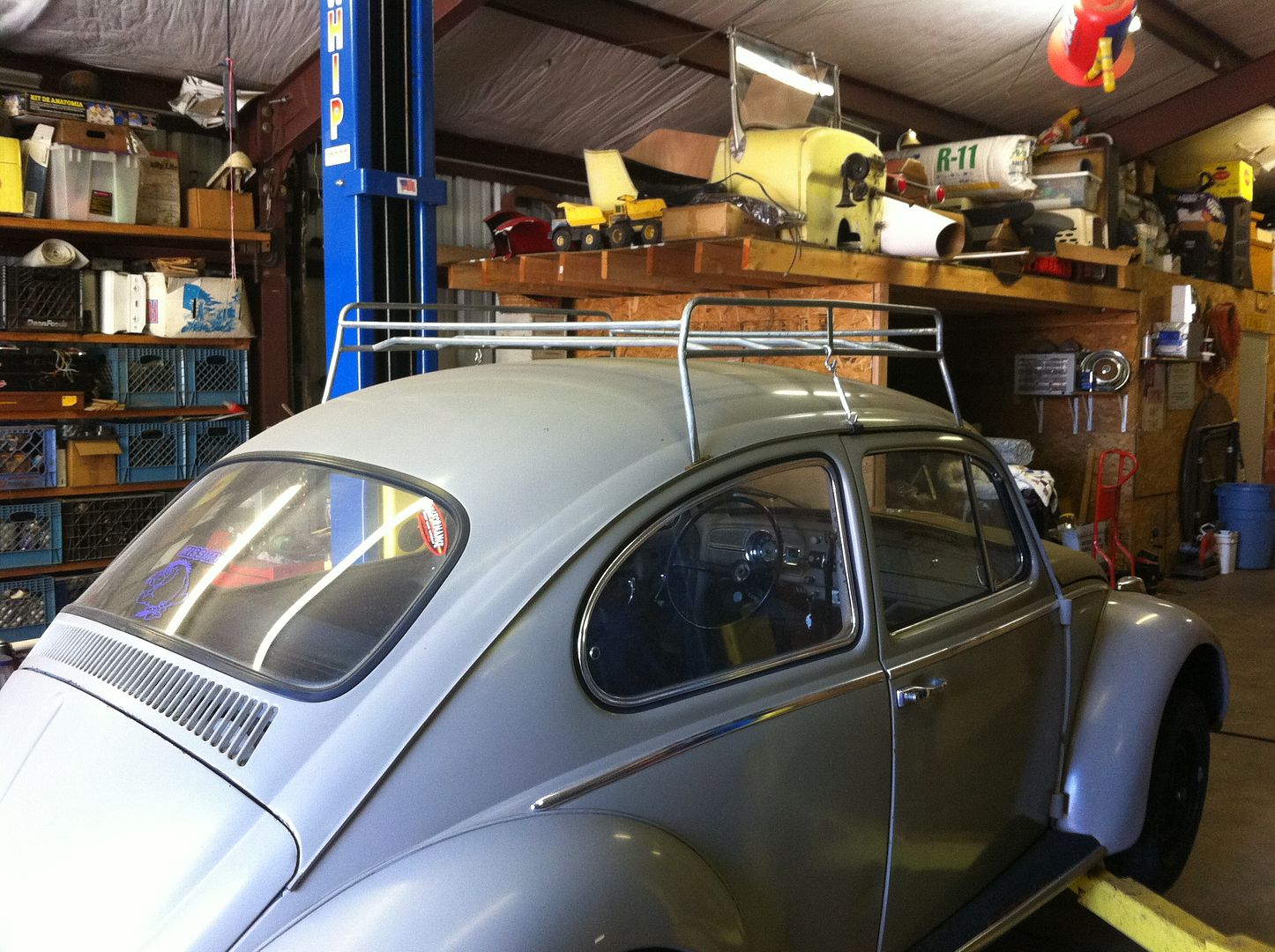

PostPosted: Fri Oct 21, 2011 8:50 pm    Post subject: Reply with quote
justcruzin wrote:
Not the best pics, but it is on the car! LOL Car is still on the lift though and the lighting sucks.
nice rack! i have the same rack on my 66 and i just modified it to sit closer to the roof.

After talking about things and how this motor seems to keep giving us hassles, we have decided to put hubby's 1776 in the bug for now. That way I can at least drive the bug and slowly rebuild it's 1600. We already did the p's and c's on it, so we can rebuild the heads, change the distributor and finally take our time and get it dialed in the right way. Tomorrow I will start the process of digging his motor out. It is currently on a shelf, buried by totes and other misc. stuff! LOL I'm not sure when we will get to the R&R of the motors, but I'm hoping to get it done soon. I so want to drive my bug. Very Happy
After having the running issues today, I kind of gave up on the car. Later in the day I had second thoughts and decided to work on other things that need to be done. So I finally fixed my horn. The PO had installed a push button horn that was attached to the side of the column. I wanted the stock horn. I had already purchased a new to me (used) horn ring and all of its bolts and all. I figured out that I was missing the wire that runs down the column. After running a new wire and installing the horn ring, I figured out it still didn't work! LOL I checked for power at the horn and had it, so that meant my horn was bad. R&R'd the horn and I am good to go!! Very Happy
New wire installed,
Horn ring installed, finally! Very Happy I bought this at the last Bugorama, so that kind of tells how long it has taken me to get to this project. LOL
So even though I can't drive my bug, I can at least sit in it and drive my neighbors crazy by honking the horn! LOL
