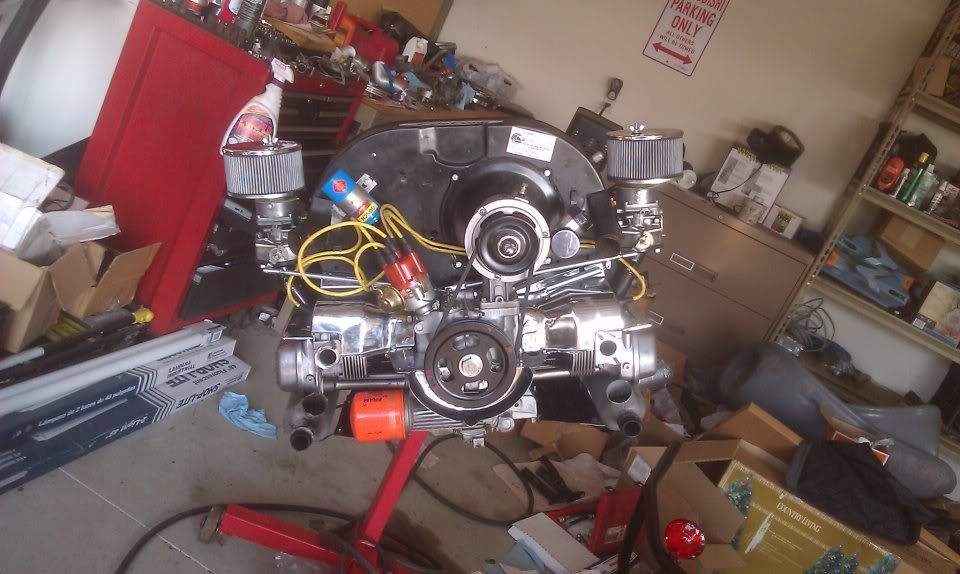

PostPosted: Sun Sep 02, 2012 8:08 pm    Post subject: Reply with quote
Front is all welded up and body parts put on, just need to put in and wire headlights and modify front bumper
Working on dual carb setup. In picture I put on a different pulley and painted it black with red T, 7.5, and B marks, new oil filter housing, dual carbs, 75amp alternator, SVDA distributor

PostPosted: Wed Sep 05, 2012 6:02 am    Post subject: Reply with quote
alexvw wrote:
I have a question about the SVDA: Where does the vacuum line go to on the distributor, a tee then to both the manifolds?
Did you get the kads setup for a vacuum advance distributor? It should go to a nipple on the left carb.
